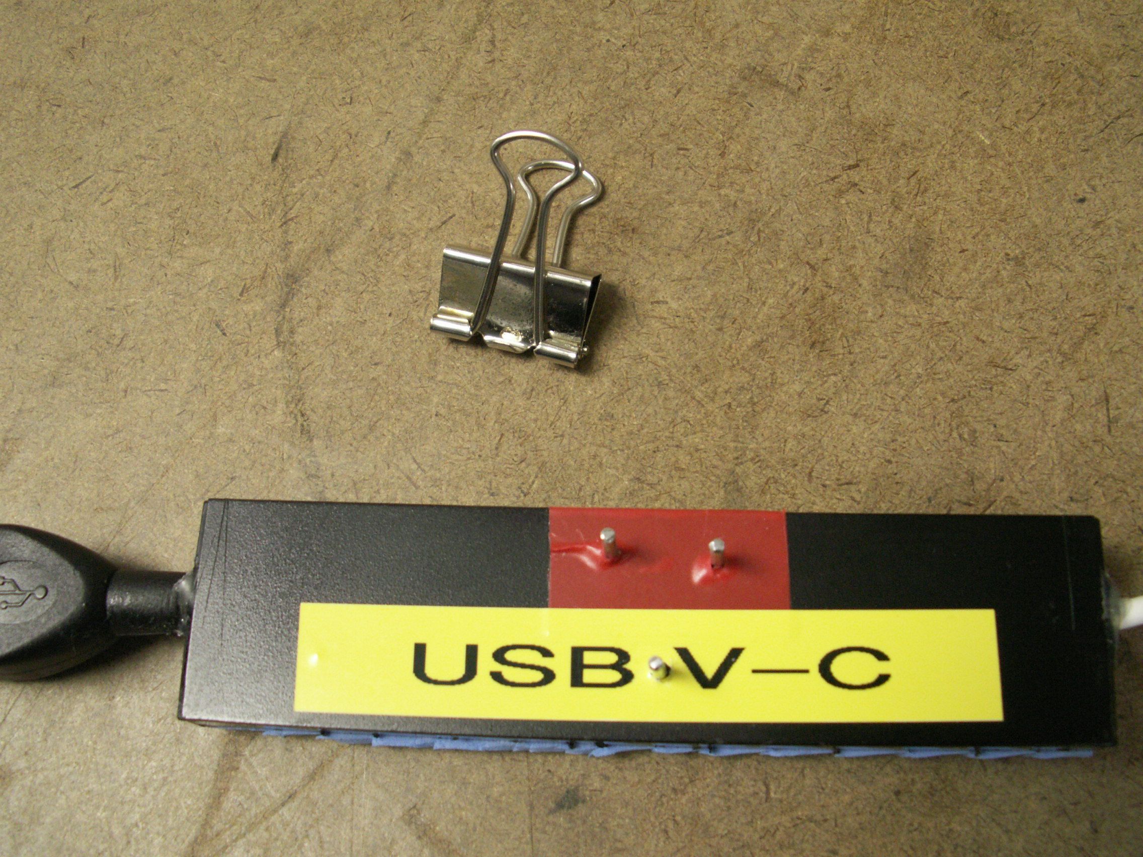

Once it is wired, TEST IT!!!!
The switch should allow you to switch between measuring VOLTAGE and CURRENT.
You might want to label on the bottom of the device which position does what.
Like before:
For Voltage, the RED lead from your multimeter to either of the TWO loops on one side.
Use the BLACK lead on the SINGLE loop.
For Current: move the SWITCH, and put the BLACK lead on only ONE of the TWO loops on one side, and put the RED lead on the other of the TWO loops.
Step 7: Finally!!!
At this point, after I insured that it worked, I filled the case with EPOXY and called it a day.
The only thing I will be adding to it is to make it look a little better or paint something on the bare spot on the top!
