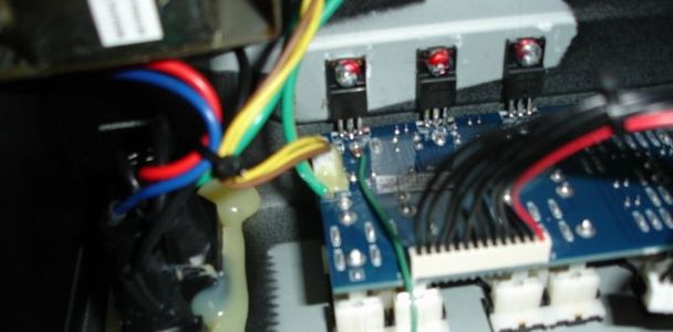

The DX052 comes apart very easily, unscrew the top and disconnect all cables. The cables that connect the mixing controls to the power supply are socket connections.
With a multi-meter find a connection near the power supply to pull DC voltage. The one I used was 16v. Carefully solder a wire to it to feed the voltage regulator.
