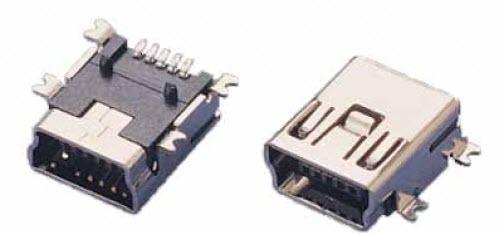

R1 is a pullup resistor for the reset pin and C1 and C2 are decoupling capacitors to reduce the supply noise. C3, C5, and Y1 build a clock generation unit. C6 reduces the VUSB rail noise. USB1 is an SMD USB-mini connector for the USB cable connection. C4 and FB1 reduce the +5V USB supply noises. Figure 2 shows a picture of an SMD USB-B mini connector.
Step 3: Figure 2 an SMD USB-mini Connector

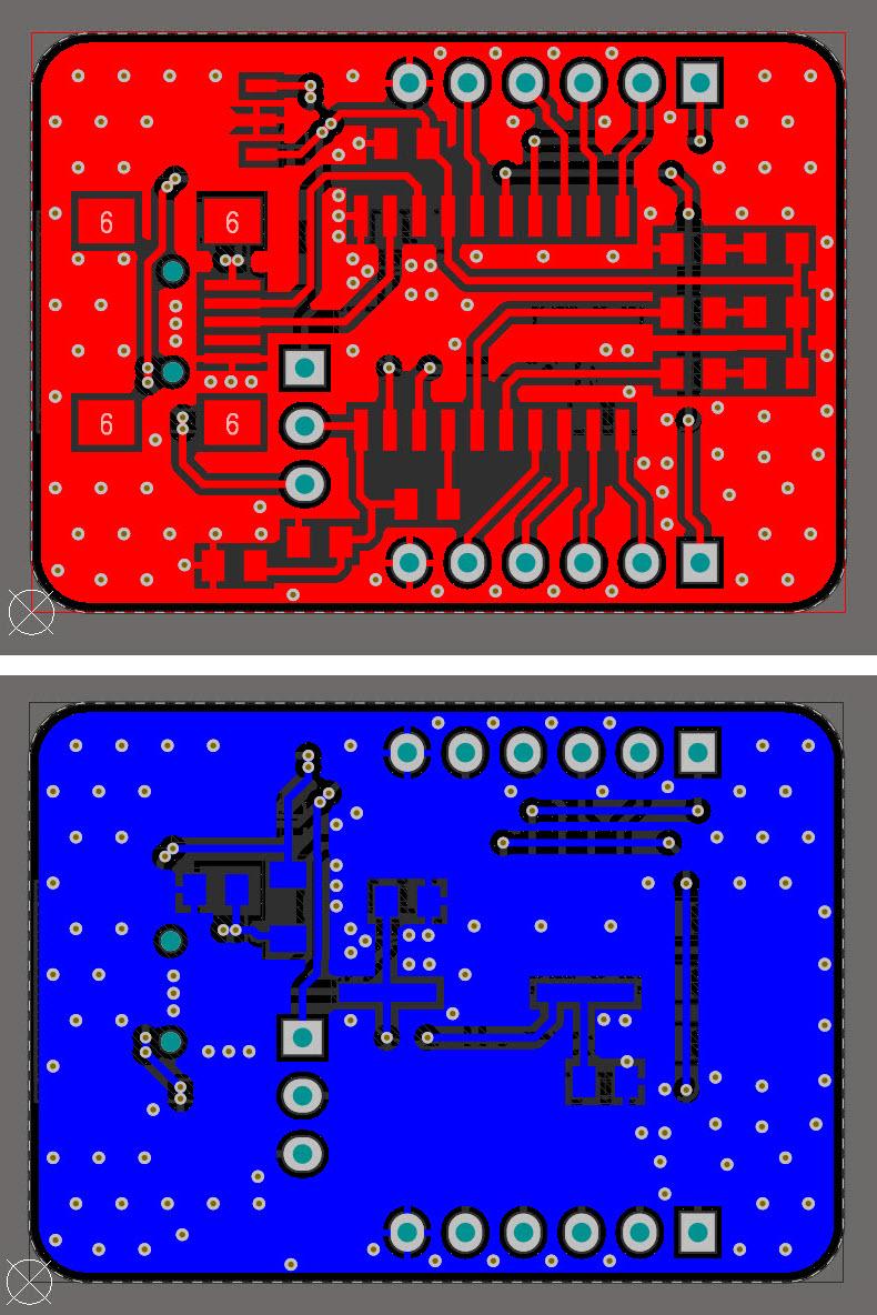

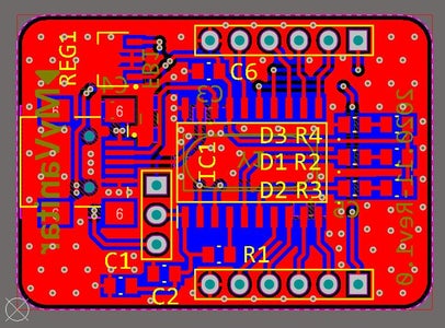

Figure 3 shows the PCB layout of the USB to UART converter module. It is a two layers PCB board and all component packages are SMD (except pin headers).
Step 4: Figure 3 the PCB Layout of the USB to UART Converter Using MCP2200
Figure 4 is a separate view of the top and bottom layers, so the red layer is the top and the blue layer is the bottom.
Step 5: Figure 4 a Separate View of the Top and Bottom Layers of the PCB

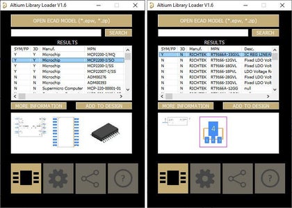

When I decided to design the schematic and PCB for this project, I realized that I don’t have the component libraries of IC1[3] and REG1[4] in my component libraries storage. So, as usual, I decided to go with the SamacSys IPC rated component libraries and installed the missing libraries (schematic symbol, PCB footprint, 3D model) using the free SamacSys tools and services.
There are two options to import the libraries into the Electronic designing CAD software: you can visit the componentsearchengine.com and download and import the libraries, or you can use the SamacSys CAD plugins and directly search/import the models into the design environment. Figure 5 shows all supported electronic designing CAD software [5], as it is clear all known software are supported. I use Altium Designer, so I searched and installed the missing libraries using the SamacSys Altium plugin (Figure 6) [6].

Step 7: Figure 6 Selected Component Libraries in the SamacSys Altium Plugin

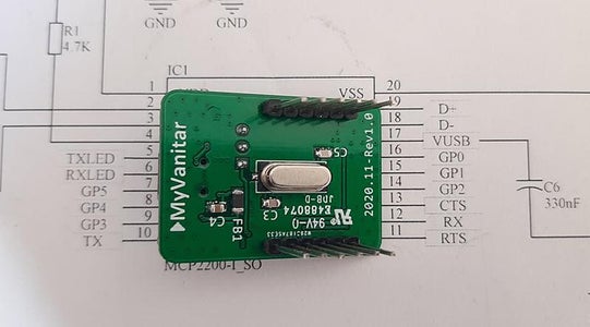

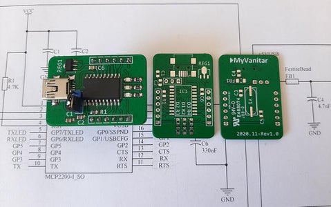

Figure 7 shows a top view and figure 8 shows a bottom view from the assembled PCB board. The PCB boards have been fabricated by PCBWay. I got up to 10 boards with no price change. The quality of the copper, silkscreen, and solder mask was good, so I had no problem with soldering the components at all. The smallest package size of a component is 0805.
Step 8: Figure 7 a Top View From the Assembled PCB Board
Step 9: Figure 8 a Bottom View From the Assembled PCB Board

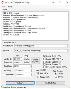

After you finished the soldering (or received the assembled board), you should connect the module to the computer and configure the MCP2200 chip, if it is necessary. Microchip provided a utility software to configure the chip [7], named “MCP2200 configuration utility”. Figure 9 shows a screenshot of the utility software. In my case, on the first try, LEDs were not blinking, so I had to enable the blinking in the configuration.
Step 10: Figure 9 Microchip MCP2200 Configuration Utility

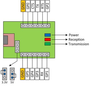

Figure 10 provides the wiring diagram of the module. With this guide, you should not have any problem with connections and wirings.
Step 11: Figure 10 Wiring Diagram of the USB to UART Module

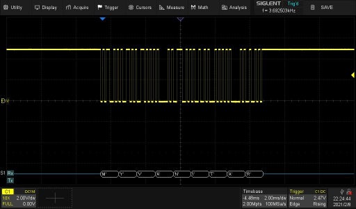

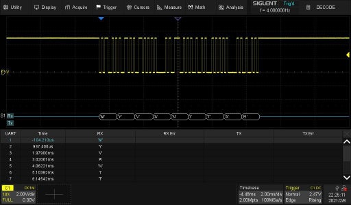

I connected the RX signal of the module (computer is the transmitter) to the Siglent SDS2102X Plus oscilloscope [8] to examine the signal and decode the data. At the same time, I played with the jumper to switch between 3.3V and 5V logic levels. Figure 11 shows the UART signal and the decoded data and figure 12 shows the same signal with the enabled result-list that can be used to examine the timing, errors .. etc. For more details please check the video.
Step 12: Figure 11 Decoded RX-UART Data Using the Siglent SDS2102X Plus Oscilloscope
Step 13: Figure 12 Decoded RX-UART Data Using the Siglent SDS2102X Plus Oscilloscope (enabled Result-list)

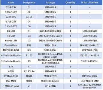

Figure 13 shows the bill of materials for this project.
Step 14: Figure 13 Bill of Materials
