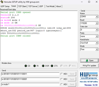

With assembly complete, connect your module via USB to your computer and open the serial port for it. I used Hercules setup utility for this task.
If it is functioning correctly, sending the command 'version' should return the current firmware version (2.1.0 as of this publishing). Attached is an API reference guide for this module, including status code meanings, command strings, and message structures for both synchronous and asynchronous messages.
In the test screenshot here, I followed these steps:
Check firmware version - passed
Check system status (code 256 means the transmit buffer is empty) - passed
Check system receiver mode (returned automatic receiver disable) - passed
Change receiver mode to always on - passed
Transmit a 24-bit word and verify transmit-complete and received-message messages are as expected - passed
Received word ignored the synchronization bit, as expected per default system settings
Transmitted word prepended a synchronization bit, as expected.
Both transmit-complete and received-message asynchronous messages were returned, as expected.
