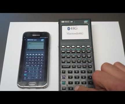

Step 5: First Circuit
The picture shows the first try. It worked out, therefore the wire-mess was never changed...
The usb plug subsitutes the serial plug. The ACRISP Plug is behind the IR-cover.

Step 7: Testing
The keyboard appears as standard keyboard and does not need any additional driver.
