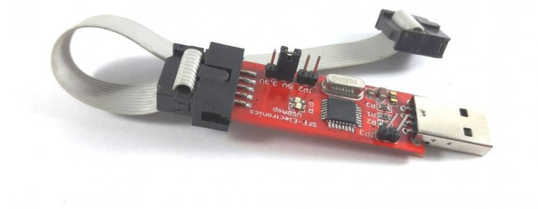

USB ASP is a device that is often used to upload programs into a micro-controller because it is easy to use and of course it is also cheap! USB ASP itself is compatible with some compiler, of course with different settings.

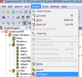

First, open the created project.
Then, select "project" on the Codevision AVR menu tab and choose "Configure"

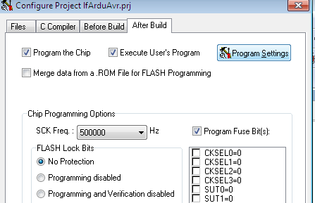

In the configure project view, select "After Build" on the menu tab.
Then, check "Program the Chip" and "Execute User's Program".
And, click the "Program Setting".

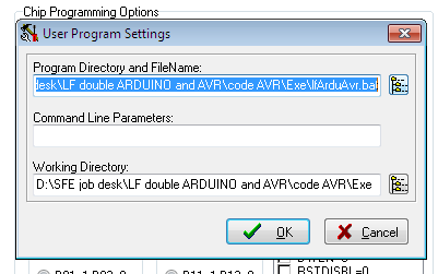

Step 6: Codevision AVR Setting: Program Setting
In the program settings, browse and grab the .bat file in "program directory and file name" and enter the EXE folder directory containing the .bat file in the "working directory".
And then, click OK.

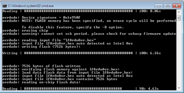

Click "build all" on Codevision AVR or CTRL + F9.
And then, select Execute user's program.
Step 8: Codevision AVR Setting: Finish!
If it works then the display will appear as picture above. Ignore the error notification of "comport".
