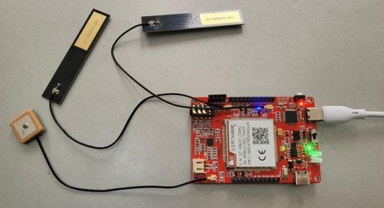

  • Plug the Battery into the battery connector in the board or plug USB for powering the module.
  • Plug the SIM card into the sim card slot of the module.
  • Plug the GPS antenna into the interface.
  • Plug two 4G-GSM antennas into the main antenna interface and auxiliary one.
Note: The glowing of blue led on module indicates GSM MODULE SIM7600 is working.
