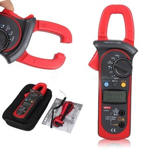

So, you have a UT203 and don't want to buy another clamp multimeter with oscilloscope output.
Here is the instructables for creating one.
Unfortunately you can't directly connect UT203 to scope. The voltage output from "clamp" is only in mV.

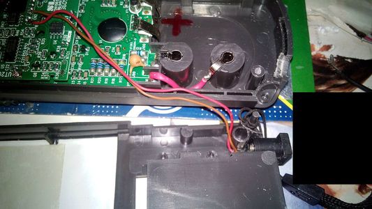

First you need to open UT203 and connect to "clamp" output..
Step 1: Open Case and Connect to "clamp"
Open UT203 casing and connect to "cn2" like on the picture.
Red wire is (+) positive and brown wire is ground.
You can add DC male plug, for quick connection of external op-amp,
or you can permanently connect it to op-amp.
