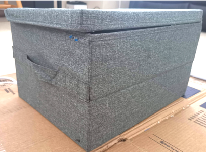

  • The box can be made out of any material and the size largely depends on your need.
  • You can use a banker’s box, a shoebox. In my case, I found a storage box on amazon. Size is dependent on how many devices you want to store on it.
  • I would suggest at least 30cm x 20cm x 20cm. Size of UV-C light bulbs and adapter may vary, make sure you read rest of the instruction first, and reserve enough space for the bulbs

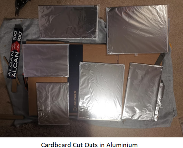

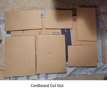

The purpose of the Aluminum is to add another layer of protection to prevent UV lights from leaking, and to add reflectivity of the UV-C light so all sides get exposed to the UV-C rays evenly
1. Measure inside dimension of the container of choice, and make cardboard cutouts of it
2. Glue a layer of aluminum foil over these cardboard cutouts to maximize reflection and allow the UV lights to distribute evenly
  • Remember to put aluminum foil in the inner side of the lid

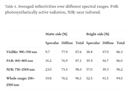

Note: according to research done by Pozzobon, V., et al (2020), the bright side of the aluminum foil offers better specular reflection, while the matte side offers a better-defused reflection. (See Picture 3). This means if you want the light to scatter evenly throughout the box, use the matte side of the aluminum on the panel. If you want concentrated aluminum lights in a certain part of the box, with a few relatively darker spots, then I would recommend using the bright side of the aluminum foil.
Pozzobon, V., et al (2020) Household aluminum foil matte and bright side reflectivity measurements: Application to a photobioreactor light concentrator design. Retrieved on April 13, 2020, from https://www.sciencedirect.com/science/article/pii/...

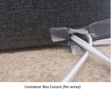

On one of the corners, carefully make a cutout that is large enough (about 2cm x 3 cm) for a single plug to go through, this is for wires to pass through in the future. One tool that I found really effective at cutting thick cardboard is tin-snip. But you can use an Exacto knife or scissors too.
Note: In the image below, I taped the size of the cutout to give it extra strength so the box doesn't fray

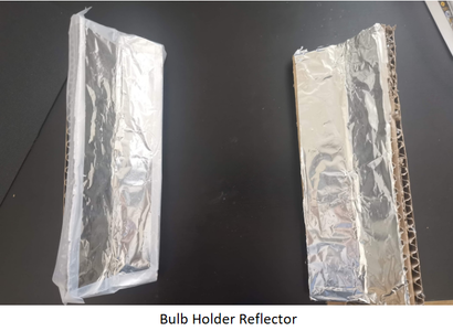

  1. The purpose of the UV-C Bulb Shield is to block lights from the bulb from shining directly up (into your eyes when you accidentally open the box) and redirect light downward where the object you are trying to disinfect is. Refer to 2nd and third picture as installation reference
  2. Cut out two pieces of cardboard to make 2 light bulb reflectors, with the width about 8cm and length about 3.5 times the diameter of the UV-C bulb of choice.
  3. Fold it into a right triangle on the longer edge, and curve the hypotenuse of the right triangle by pressing on the surface
    1. This will make it easier to install the light adapters for the UVC bulbs because it will better fit the size of the bulb
  4. Put aluminum foil also along the hypotenuse side. This is the bulb reflector, which is also responsible for redirecting UV lights downward and blocking the UV light from shining and directly harming the user’s eyes if the fail-safes failed.

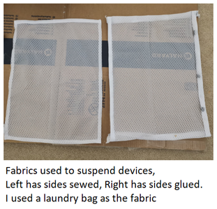

I used a laundry bag for the net, ideally, you just need a piece of fabric that is translucent, and can be see-through by the ultrasonic sensor. Some examples of these materials include fruit bags (Refer to 4th image for this step), laundry bags, window screens, etc.
  1. Fold the sides of the net in, and sew the sides in place, so the edges are firm on the edges. This will make this step much easier (Refer to 1st image for this step)
    1. You can also consider gluing the sides in, but it won’t look as nice as sewing

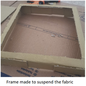

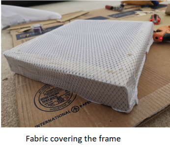

  2. Build a frame for the net so you don’t have to glue it directly onto the aluminum walls, and hopefully, this will make the repair easier. You can build this frame either from scratch using cardboard, or use the box you find from dozen of canned drinks, hollow the inside out. (Refer to 2nd image for this step)
  3. Spread the net along the side, glue it in place, make sure the net is tight (Refer to 3rd image for this step)

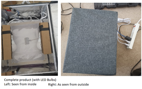

Glue light reflector that we built earlier in place, put UV bulbs in the light socket adapter, and tape (or glue) it onto the reflector. (Refer to 1st image for this step)
