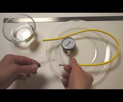

Step 1: Materials Used:
Step 2: Repair in 60 Seconds!

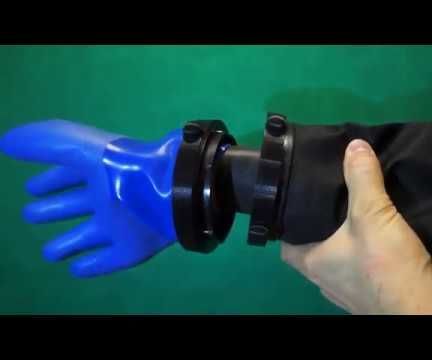

Light UV torch inside the suit and you will immediately see where the leak is.
Apply a small amount of UV glue on the hole and UV light it for just 30 seconds.
That's it, no more problems!
UV adhesive has excellent adhesion to trilaminate, neoprene and most other materials. Glue is very fluid, easily penetrates through the hole and it improves the quality of the repair. After polymerization the adhesive becomes like a soft and elastic rubber.
