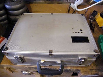

Here are the pictures of my UV LED PCB exposure box, I made it because I wasn't having much luck with the "Press n Peel" method of PCB production and well it sounded like a cool project.
I made it by following this web site http://www.innerqube.com however it doesn't have any useable files apart from the Arduino code, which i needed to edit anyway but if you head over to my web site I have uploaded a schematic which can be opened and edited in Diptrace available here http://www.diptrace.com

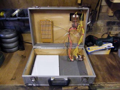

The UV LED PCB exposure box is made up of a number of parts they are;
The Paperduino - Which I made following this guide http://txapuzas.blogspot.com/2010/07/paperduino-stripboard.html
The Paperduino is the control for the UV LED PCB exposure box, it allows you to select the exposure time and then displays a countdown of the exposure time. It also controls the UV panel with the aid of a IRF530 Mosfet which turns the UV LED panel on when the exposure is started and off when the exposure finishes. This is on a second strip board along with most of the wiring.

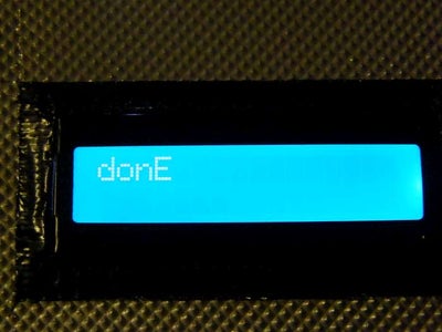

The Control Panel - This is made up on 3 tactile switches, which increase, decrease and start the exposure. And a Piezo speaker to tell you when the exposure is complete.
The LCD - This is used to display the exposure time and displays the message "donE" when complete, who can tell me where this reference comes from? :-)

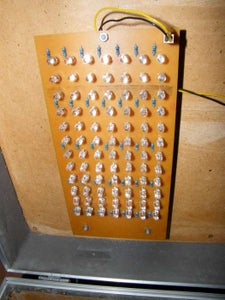

The UV LED Panel - This is made up of 84 UV LED's each row of 3 LED's having it's own 100ohm resistor too. I have included a jpg on the PCB and as you can see there is the option to add an extra 21 LED's and resistors if you wanted to increase the exposure area, however my power supply wouldn't allow for these extra LED's.
LED specs:
Forward Voltage : 3.2 - 3.6
Forward Current : 20mA
MCD: 3,000
Lens Colour : Water Clear
Emitting Colour : UV

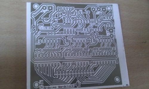

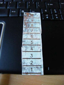

The UV LED PCB Exposure Box uses two 12v 600mA power supplies (1 for the UV panel & 1 for everything else) The last 2 picture show the first test exposure PCB and the PCB i made for my Arduino "Word Clock". Overall i'm very happy with how it came out and plan on using it again soon.
