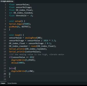

You'll want to declare all your floats at the top of the page. Right now, we are just focusing on the sensor, so lines like "pinMode" that you see in the second image will come in the next step. At this point, we just wanted to test if the sensor would read, and with this code, we were able to open the serial monitor on Arduino and see the numbers that the sensor was getting once in contact with UV light. (You'll probably have to step outside to check)
Step 6: Add If Statements for the Vibration Motor
The included image and file is the full code so far. You'll want to add an If statement to tell your motor when to vibrate.
if(sensorValue >= 40){
digitalWrite(6,HIGH);
delay(1000);
That piece of code uses the analog value to read how high the UV is, and then tells the vibration motor to buzz if it's too high. My threshold is a UV index of 6, which poses a moderate risk, but you can change this number to whatever you chose at the top on the float threshold line.
An If Else statement tells your motor to stop vibrating if the analog sensor isn't reading a value that reaches the threshold. Here is what this line looks like:
}else{
digitalWrite(6,LOW);

Now you can plug your UNO R3 into your computer using the USB port. I always verify my code to make sure there are no problems. One it's verified, you can upload the code and open the serial monitor to see the output the sensor is reading.
Place the sensor in the sunlight to get a vibration, and place it in the shade to stop the vibration. You may have to adjust your threshold to a lower number if the UV index isn't very high, but once you know it works, you can change it to only vibrate when the UV index is at the level you want. My serial monitor output is reading 0 in the image because I was inside at the time.
When tested outside however, you can see the vibration motor going on and off when transferred from sunlight to shade.
