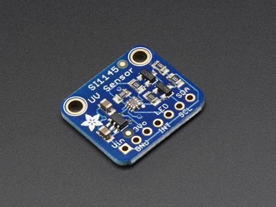

  2. Adafruit Si1145 sensor

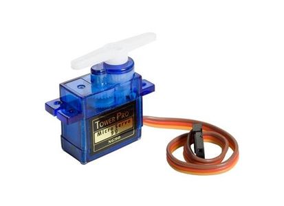

  3. Servo Motor

UV Sensor:
Connect the SCL pin to D1 on the mini, the SDA to D2 and then the power to 3V and ground to ground.
Motor:
Connect the data pin to D3, the power to 5V and ground to ground.

Tie all the petals together with string and attach that string to the servo motor. Attach the servo motor to the side of the pot so that when the motor spins, it pulls the petals down or pushes them back up.
