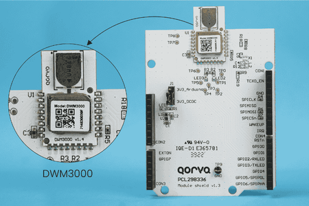

Step 1: Quick Hardware Notes About the DWM3000
  1. Built on Qorvo DW3110, supports IEEE 802.15.4z and FiRa PHY/MAC.
  2. Comes with an onboard UWB antenna, crystal oscillator, power management. No RF design required.
  3. Channels: it supports Channel 5 (6.5 GHz) and Channel 9 (8 GHz). I used Channel 5.
  4. Data rate: up to 6.8 Mbps which lets measurements run faster.
  5. Range: open field up to ~200 m. Indoors expect 50 to 100 m useful range with typical accuracy near 10 cm depending on environment.
  6. You must calibrate antenna delay or you will be off by a few cm. Typical TX antenna delay I used: 16350 ticks.
