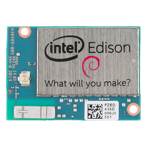

In this instructable, I will be demonstrating the windows method of installing Ubilinux on the Intel Edison. Ubilinux is based on the Debian flavor of Linux, which many Makers will find familiar and be very comfortable with. The Yocto Project is a well thought out platform, but it can be a little daunting to work with if your goal isn't a dedicated finished project. Ubilinux is a more feature filled package that doesn't require you to essentially rebuild Linux from scratch to obtain your end result.

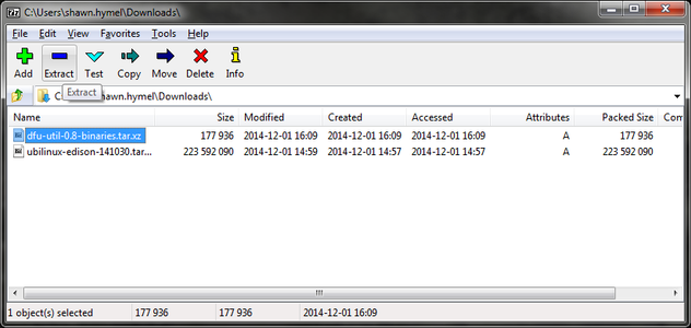

You will now want to open 7Zip, and select the 7Zip file manager. From here you will want to navigate to your downloads folder and select “dfu-util-0.8-binaries.tar.zx” then select "Extract" (Refer to the first Image for a visual reference)
Next we will click "Ok" when prompted on where to extract the files to accept defaults.
At this point “dfu-util-0.8.binaries.tar” will appear in the 7zip file manager, double click on it to enter the folder.
Now we will select "dfu-util-0.8-binaries.tar" and select "Extract" to finalize the dfu-utl extraction process.
Click "OK" when prompted, then press the "up one folder" icon to return to your download folder.
you will need to repeat these steps with the Ubilinux image as well

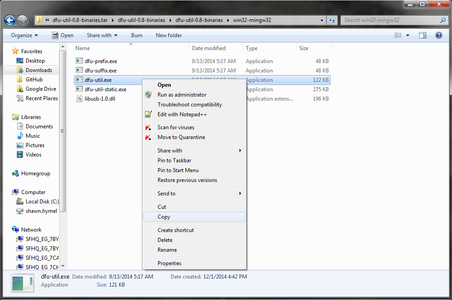

Right-click on dfu-util.exe and click “Copy.”(image 1)

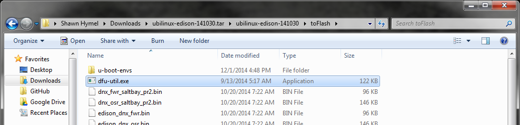

Navigate to the toFlash folder, which is in the unzipped Ubilinux folder (\ubilinux-edison-141030.tar\ubilinux-edison-141030\toFlash). Right-click and select “Paste” to paste in the dfu-util.exe file.(image 2)

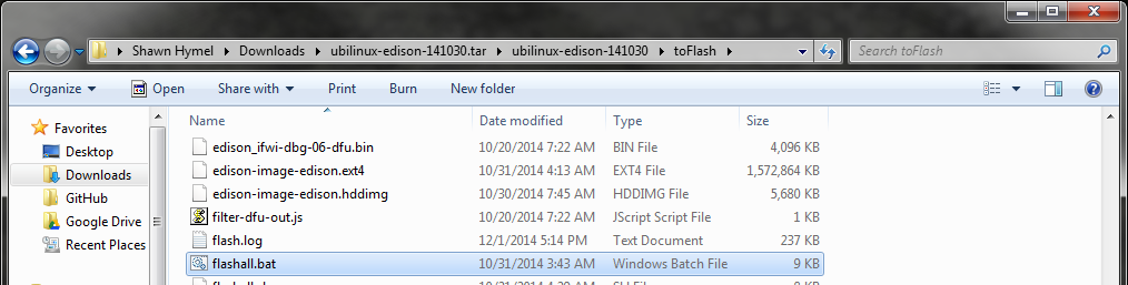

In the \toFlash folder, scroll down to find the file “flashall.bat.” Double-click it to start the install process.(image 3)

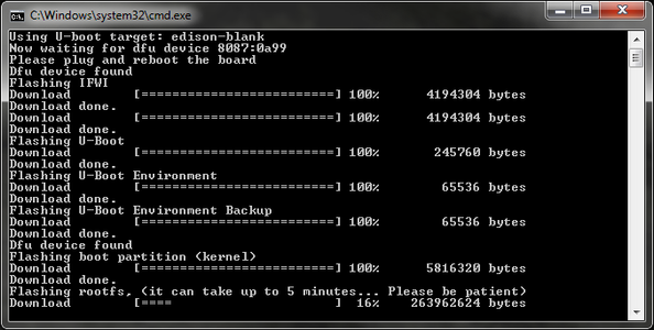

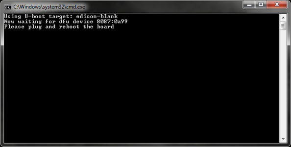

A command window will open up and ask you to plug in your Edison.(image 4)
Plug in your Edison (Use J16 for the Intel Arduino and Mini-Breakout boards. Use “OTG” for the SparkFun Edison Base Block), and the installation process will begin!
Caution:Once the command prompt window closes, you will need to wait at least 2 minutes for the installation to complete. The Edison should reset a couple of times to finalize its installation. Do not unplug the Edison! It’s probably a good idea to walk away for those 2 minutes.(image 5)
