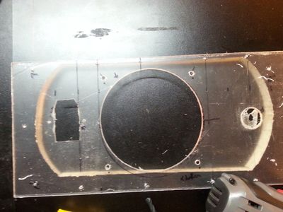

3. Without getting into too much detail about how to measure, draw lines, or cut holes let me just say this. Lexan is hard to work with. It is brittle, hard to cut and score, any cracks run like they do in a sheet of glass if you tighten something down too tight. It's a little bit sharp on the edges so its a good idea to "seam" the edges (round them down with some sand paper).
That being said, I used a 120MM hole saw to cut holes for my Coolermaster PC case fans, a 13/16" hole saw for the Neutrik panel mount passthrough connectors, the jigsaw for detail work, and a few different drill bits for the various holes needed for mounting and attaching things. You tool requirements will vary depending on what ports and options you decide to install.
Mine is pretty complicated as you can see and I used a big stack of bits, files, and power tools.
3-a. Make a mock up of how you want everything laid out on the back panel and measure from the edges.
3-b. Use a Sharpie to mark important measurements and start boring and cutting.
- The left side will house the power plug with fuse assembly, a 120MM fan to force cool air into the cabinet, and a Neutrik panel mount ethernet passthrough jack for network connectivity.
- The right panel will hold our amplifier, RCA IN/OUT jacks and a second cooling fan. Small holes were drilled around the border of the Lexan pane to attach it to the backplate securely with #6 screws.

4. With all the holes in the right spots now we can add the components. Our amplifier mounts perfectly and the Lexan sheet holds it securely if we did it right. Ensure there are also no distortions in the plastic from the weight of the assembly so it looks like it will hold up well to being moved around when we get evicted because we were too busy playing games to go to work.
I used Seismic Audio RCA panel jacks for the audio in/out ports. They were relatively inexpensive and used the same 13/16" hole saw as the Neutrik ports for the USB and ethernet connections. I predrilled the screw holes and self threaded the #6 screws directly into the plastic. Connections were then soldered onto the back to complete the connections to the amplifier.
