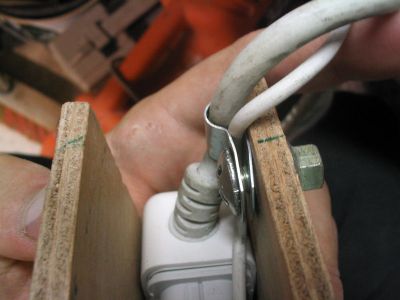

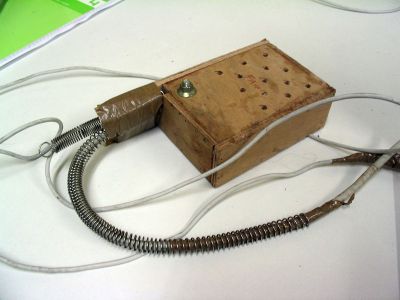

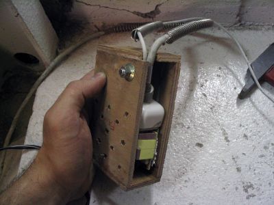

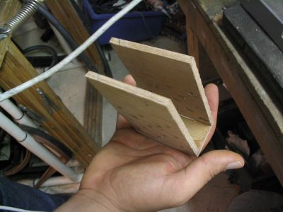

Step 2: The Replacing Box
I was in a hurry, so i just took a piece of wood and made simple (ugly) case with 'spagetti' holes.
I firmly fixed the cables so they come out by the same hole (I know it's not good ...).

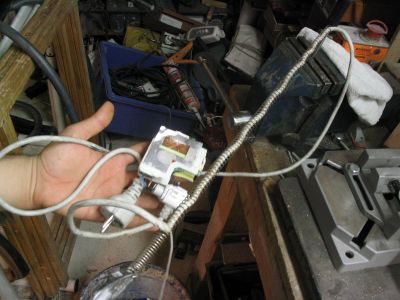

Step 3: Cable Protectors

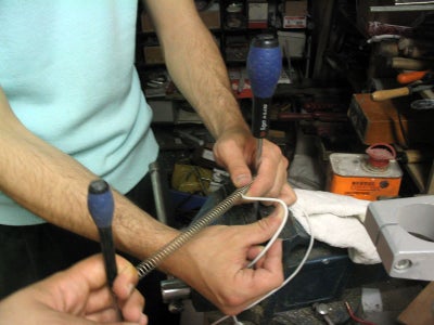

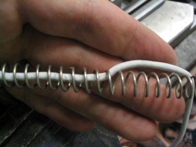

In order to prevent too radical torsion to my old cables, i used these long steel springs. My springs were so long, it took a little while, and the third hand is Nasser who popped in by chance a this precise moment of the night, thanks mate !

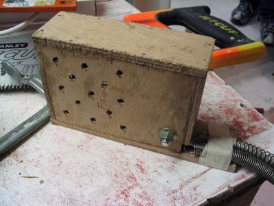

Step 4: Cable Fixing, How to Use It Now
As the cable were already firmly attached to the case, only remained the necessity to hold the cables in place, i took an other shortcut : brown tape ! hehehe.

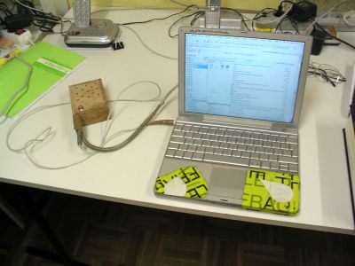

Apart from this, it works good and dissipates hit much faster than before (it used to be sooo hot). And wood is so charming.
