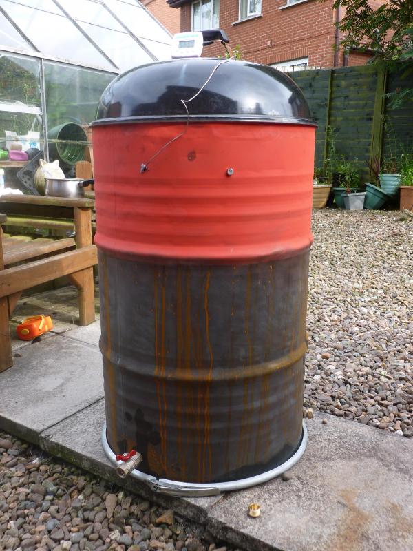

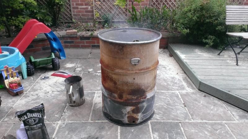

Q: How ugly can they get?
A: Decide for yourself:

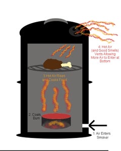

Q: How does a UDS work?
A: To get the most out of your UDS you should understand how it works so you can make adjustments. Every UDS performs a bit differently and conditions like weather (temperature and humidity), wind, and how much food you are cooking will create more variation. It will take some practice before you get it right.
The most important thing to know is that the amount of heat generated by the burning charcoal is directly related to the amount of oxygen that enters through the bottom vent. The oxygen is necessary for the charcoal to burn. The more oxygen there is the more heat the charcoal will produce.
See the picture above: air enters a vent at the bottom of the UDS (#1) and supplies the charcoal with oxygen. The charcoal uses the oxygen to burn (#2) and generates heat. Hot air (and sweet smoke) rises from the coals and cooks the food (#3). The hot air continues to rise and escapes out the top vent (#4). When the hot air vents out the top, more air (and oxygen) is pulled in through the bottom vent which continues the cycle.
Enlarging the bottom vent increases the oxygen supply which will allow more charcoal to burn, raising the temperature. Choking the vent down reduces the oxygen which will lower the temperature. Cooking with a UDS normally involves making slight adjustments to the size of the bottom vent until the smoker is running near the desired temperature.

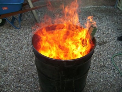

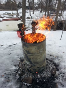

Q: Do I need to burn out my drum before using it?
A: Many DIYers will build a large fire in their drum as part of their build. The reason is that it will kill any dangerous bacteria or viruses that might be in the drum. If you know where your drum came from it probably isn't necessary but it doesn't hurt. If you're unsure what the drum used to hold then you definitely should burn it out. Keep in mind, however, that burning out your drum won't purge it of some toxic chemicals.
See the pictures above for examples of burning out a drum. After you drill the holes drop in some dry wood and let it rip. Once the file is out wipe off the resulting soot with soap and water.
