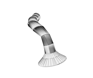

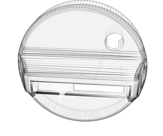

Step 1: Step 1: 3D Print
First use a 3D printer to print the two STL files. It will take about 2 hours for both depending on your printer and print quality. I was impatient so I put to the fastest speed.
Once you have printed, stick the two parts together as shown in the picture.
Ok lets move the next part...

Ok, once you have tested and is ok!, push the LED(s) into the hole under the base until you can see the light comes out on the other side and adjust as you like (see picture).
