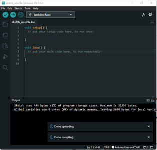

  2. After installing and opening the IDE, you will see a new file or "sketch" opened. It will have void setup() and void loop() typed into the sketch.
  3. Setup is where the code that only needs to be ran once will go
  4. Loop is where the code will "loop" indefinitely. This is where code that needs to be ran over and over again will go.

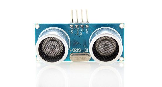

An ultrasonic sensor has 4 electrical pins.
  • Gnd (Connects to ground pin on Arduino)
  • Echo (Pin that receives the echoed ultrasonic sound)
  • Trig (Pin that tells one of the speakers on the sensor to output an ultrasonic sound)
  • Vcc (Connects to 5v pin on Arduino)

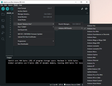

  1. We will have to tell the IDE what board we are using, and what "Port" the Arduino is connected to on the computer.
  2. Click on the tools tab, hover over boards, hover over Arduino AVR Boards, then click Arduino Uno.

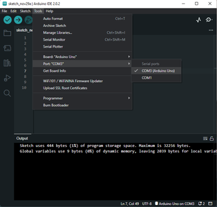

  3. Click on the tools tab, hover over Port, then select the COM Port that says (Arduino Uno) next to it
  4. It should look like (COM X (Arduino Uno).

  8. If it says Done Compiling, you are ready to upload the code.
  9. Upload the code with the Upload button next to the Verify button, it should look like an arrow.
  10. If the IDE shows Done Uploading, the code should run on the Arduino!

  • As seen in the code, we have the trig pin connected to pin 9 on the Arduino.
  • Connect pin 9 to trig on the sensor.
  • We have the echo pin connected to pin 8 on the Arduino.
  • Connect pin 8 to echo on the sensor.
