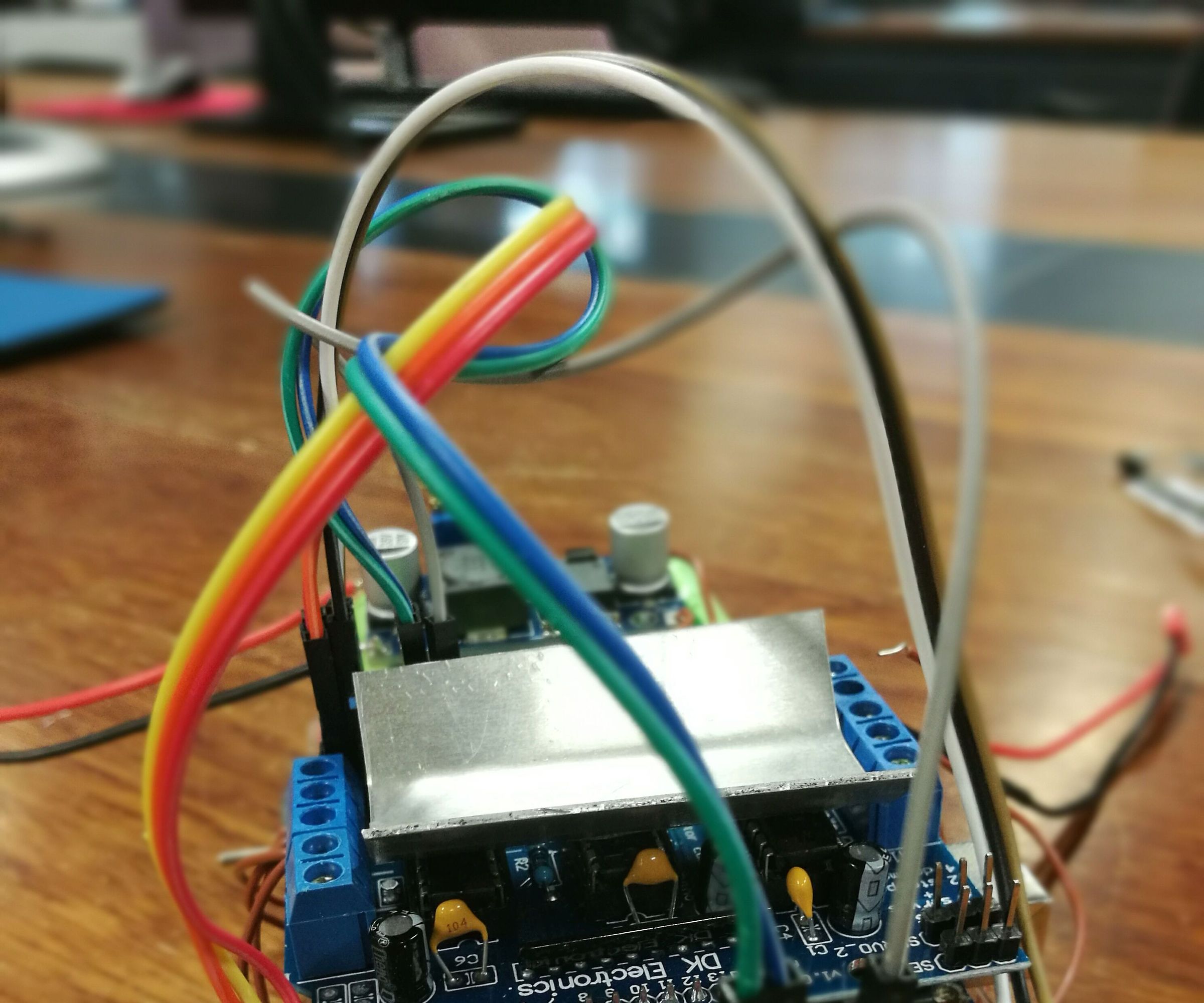

Once you have all the parts together it’s time to start into the conversion. The most straight forward first step is to add that resistor to the ultimaker. I have included some pictures of where is needs to go. It needs to be soldered at the location marked R4, just next to the marker for pin 9.
Essentially what is being done in this step is setting up a potential divider between the 5v pin of the Arduino and ground, with the centre going to the digital I/O pin 9. I have included a quick diagram from LTspice to illustrate this. As the resistance of the thermistor changed so too does the voltage at pin 9 and this is then read as the temperature value. Note that in my case the thermistor was 100k ohms, it doesn’t particularly matter what your particular one is, as it will be defined in the code later.
Note that you also need to plug in the heat bed sensor wires to the control board. There is a port marked temp3 on the ultimaker pcb, which is where you want to connect this to. In my case the heat bed came with the correct socket attached to the wires, but if yours doesn’t, you can get them fairly easily, or else maybe you could solder the wires directly to the control board, though my personal preference would be to have these connections removable.
