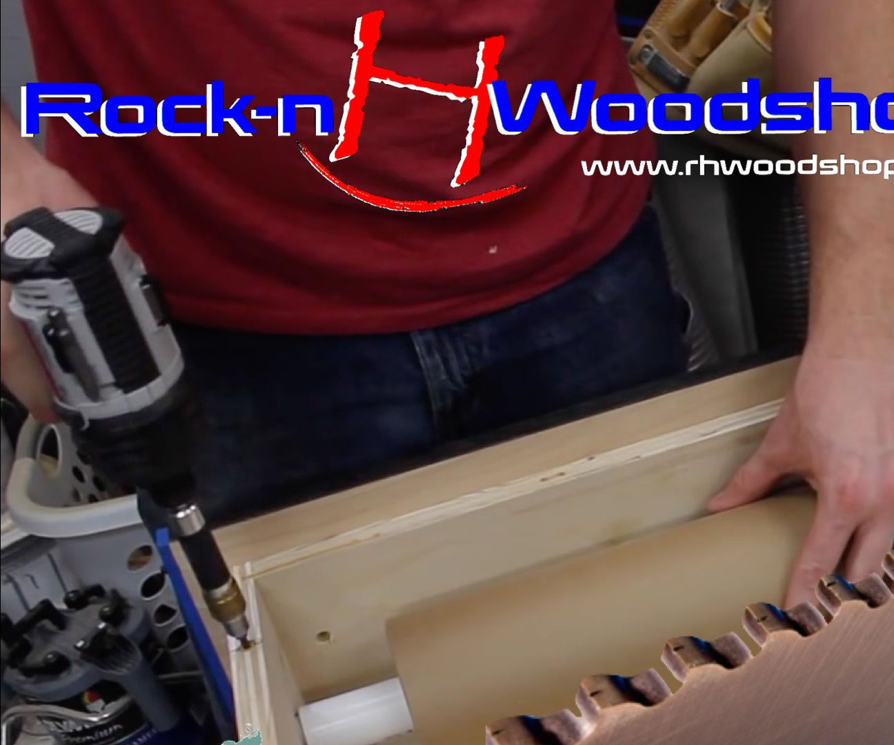

Step 25: LASTLY, ADD DUST COLLECTION!
25. Now to protect your hands from the blade on the other side of the fence, make a blade guard. It is nothing more than an enclosed box glued to the back of the fence. However, drill out a hole that will accept a 2 1/2” dust port on the right side of the box. This will enable a feature that no other cross cut sled will have, DUST COLLECTION!!!
