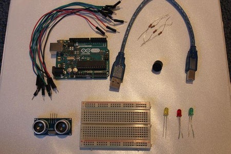

hardware stuff
I am also giving the links to the products used
  1. set of jumper wire .
  2. Arduino uno .
  3. led lights you can use any led light
  4.  HC-SR04 Ultrasonic Sensor Distance Module
  5. 1K ohm 1/4 Watt Resistor
  6. Electronic Spices Mini 5V Buzzer
  7. Bread Board . I will suggest getting this i am using it for a while and its great.
Step 1: Gathering Materials
check all material from the material list and confirm it . So that you can start

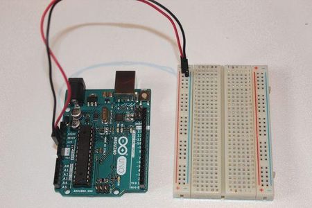

Connect a red wire from the 5V pin on the Arduino to the positive channel of the breadboard. Connect a black wire from the GND pin on the Arduino to the negative channel of the breadboard:

Step 3: Assembly - Breadboard
Great, now we’re ready to connect the Arduino to the breadboard. Remember, the wire from the 5V pin goes to the positive channel, and the wire from the GND pin goes to the negative channel. It’s important to get this right, so double-check your connections
