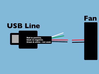

Take an old USB cable (I used one from a broken mouse) cut it off, and strip the wires. You will need the red and black wires inside the USB cable, you can ignore the white and green wires. On the PC fan, identify the positive and negative wires. On my fan, positive is yellow, and negative is black. Wire the positive line on the fan to the red line on the USB plug, and the negative to the black wire. I like to use solder on things like this, but as long as your lines have a good solid connection, you can just use electrical tape. Seal up your lines, and make sure you have no shorts.
At this point, you *could* plug the fan into a USB wall plug (a phone charger) but I picked up a portable solar phone charger from eBay for like 15 bucks, this is what I will use to power my fan. It even has a nifty little on-off switch for added functionality!
