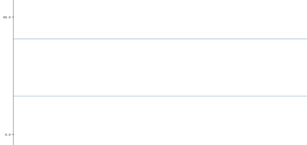

Now that you have installed the latest version of the Arduino IDE(1.6.7 or above) its time to understand how the Serial Plotter actually works. The Arduino Serial Plotter takes incoming serial data values over the USB connection and is able to graph the data along the X/Y axis, beyond just seeing numbers being spit out on to the Serial Monitor. The vertical Y-axis auto adjusts itself as the value of the output increases or decreases, and the X-axis is a fixed 500 point axis with each tick of the axis equal to an executed Serial.println() command. In other words the plot is updated along the X-axis every time the Serial.println() is updated with a new value.
Remember to set the Baud Rate of the Serial Plotter so that it matches that of the code.
Multiple Plots
When displaying multiple waveforms, every separate variable/value/parameter is displayed using a different colour like shown below.
Inorder to plot multiple variables or waveforms simultaneously a 'space' is printed between the two print statements.
Serial.print(temperature); Serial.print(" "); Serial.println(humidity);
OR
Serial.print(temperature); Serial.print("\t"); Serial.println(humidity);
In this case the values of the variables 'temperature & humidity will have separate waveforms plotted on the same graph simultaneously.

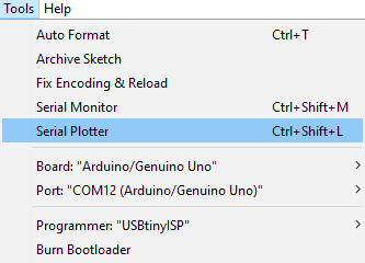

Whether its a singular wave or a multiple plot graph the Serial Plotter auto-resizes itself and color codes each wave. In-order to test the Data Visualization function you can follow the following steps:
- Connect a couple of sensors to your Arduino
- Print the values of the sensors & Upload the code.
- Open the Serial Plotter.
