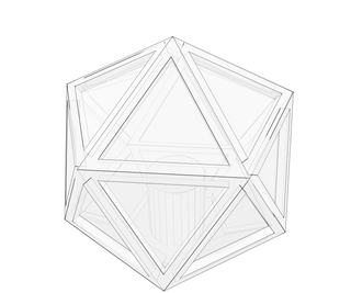

Now the observant among you may have noticed one omission of hardware: drawer pulls. Well, enter the attached CAD model screenshot. As it may not have been completely obvious, I am a geek, and proud of it! So I needed the final little touch of geek, to end this build. That is why I've elected to have my drawer pulls 3d printed. I designed a model of a 20-sided die (a.k.a. an icosahedron), and after some clean-up on the model, I'll be submitting it to an online 3d printing service. I've included the SketchUp files as well as an STL export for those interested.
