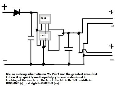

A) Protect against backwards connections so that simple accidents such as this wouldn't damage it
B) Provide power for USB charging devices (like the iPod, Sansa, etc) in addition to PDA/PSP
C) Provide 2A of power instead of 1A, my PDA running on full speed/brightness with WiFi and Bluetooth on apparently used more than 1A (7805 = 5v at 1A) and it would stop charging
To do this, I decided to add a diode at the beginning of the circuit (diodes only allow power to flow in one direction, preventing the backwards flow that destroyed my previous model). To accommodate 2A instead of just 1, I added a second 7805 chip in parallel with the first one. Since each chip provides 1A, 2 of them provide 2A. I also pulled some USB connectors off of a dead USB hub and added one to the circuit so that I could plug iPod/Sansa/other USB charging devices into it and charge them on the go.

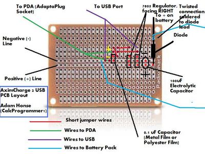

Step 6: Solder Away!
Now you can begin assembling the circuit. Below I've posted a schematic diagram, a circuit board layout diagram, and a bunch of pictures of me assembling it. Be sure to keep your board compact and your solders clean, as that will help when you are trying to cram it into a 9v case.
In the last picture, the BLACK wires are POSITIVE while the plain RED wires are NEGATIVE (yeah, it's backwards from normal, but I didn't look when soldering them to the connectors and got it backwards). For the AdaptaPlug socket, look for the word "Tip". Face that mark towards you. The wire on the LEFT is POSITIVE, the wire on the RIGHT is NEGATIVE. On my socket, the left wire has some words on it, so the words also indicate positive (when attaching the AdaptaPlug B connector, line the "+" to the "Tip" mark because the Dell Axim power pack indicates that the Axim is "plus tip" where the tip (inside portion) of the connector is positive while the outer ring is negative.
