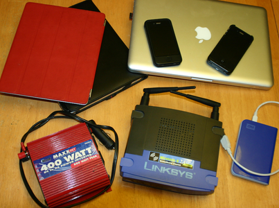

Step 1: Requirements
The minimum requirements for this setup are as follows:
- A WiFi Router. I use an old Linksys WRT54G, but almost anything should work. Depending on the router you choose to use, you may also need a RG45 cable to connect directly to it for configuration.
- Air Video Server (Windows or Mac). Available for free from http://www.inmethod.com/
- Air Video Client (iOS App). Available in the iTunes app store (trial and paid versions)
- A Laptop (PC or Mac) to host the movies and act as the streaming server. It doesn't need to be a powerhouse, but it should have at least an Intel Core 2 duo or equivalent CPU. For this Instructable I used a lower end MacBook Pro but I have also used Windows based laptops to do this in the past.
- Movies or videos in electronic form (AVI, MP4, WMV, etc.)
- Movies can be either stored on master system hard drive or external USB storage drive
- Again, videos do NOT need to be converted first because Air Video can convert on the fly
- Converting physical DVDs to electronic form is out of scope for this Instructable
- Basic A/C inverter, capable of powering your laptop, wifi router and if necessary, the USB storage drive at the same time
- Something like this should work just fine if you don't already have one
Step 2: Hardware Setup
The beautiful thing about this setup is that it can all be done in advance of your trip.
WiFi Router
I use a Linksys WRT54G Router setup as a basic WiFi access point (AP). While I run the open source “dd-wrt” firmware on this router, the stock firmware should also work just fine as we’re not doing anything special with the configuration. Any router setup as an access point should work. Ideally, you should setup the access point so it has the same SSID, encryption, and password as what you use at home. This way every device will just “work” without any additional configuration provided you have already set them up on your home network. Follow the instructions for your particular router to set it up.
WiFi Router

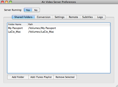

Step 3: Software Setup
AirVideo
Your central video serving device must be running “Air Video” server. This is a free software available from http://www.inmethod.com/. It works on both Mac and PC platforms. It is recommended that you setup the server with a secure password required to access your videos (under the Settings tab).
Each remote device must have the Air Video client installed. It is recommended that you purchase the “professional” version which is very reasonably priced. If all of your devices share the same iTunes account then this means just one purchase for all devices. See the requirements step for links.
Your video library can be completely loaded on your laptop or attached in a USB storage device (or both). You can have multiple locations to serve videos, as in multiple external USB drives, or multiple folder locations on your centralized server. You must configure Air Video server to point to these locations to serve the videos (follow the Air Video install instructions to do this). The process for converting videos from physical DVD to electronic form is out of scope for this tutorial.
