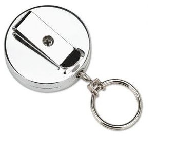

retractable key ring (I got mine at the dollar store)

Next attach the retracting key ring to the opposite side of the trap door. I did this by putting another small hole in the trap door (opposite side of the pivot point) and attaching the key ring to it with a small piece of steel wire. In this way the retracting action will keep the trap door normally shut, and will allow it to re-shut.
