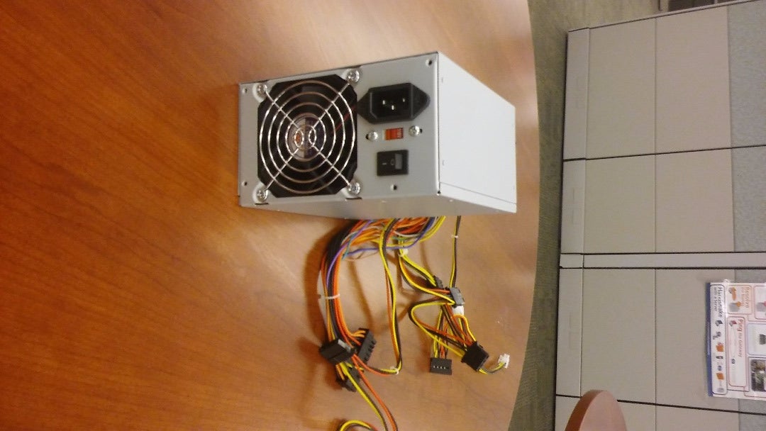

After you have installed your CPU, Ram, and Graphics Card, you will need to plug in your Orion 400W Power Supply into your motherboard. Make sure your motherboard and Power Supply are both on the static mat. Add the motherboard speaker that came with your case. Turn on your computer by connecting the two power button connectors. If there is a beep from the speaker you did everything correctly. You can also plug your VGA cable from into your motherboard and monitor to make sure your graphics card is installed correctly.

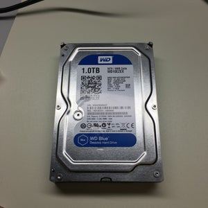

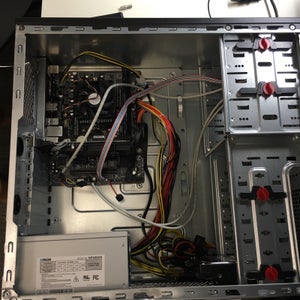

You will need to add your 1TB Hard Drive to your case. Add the stand screws to you case and screw in the motherboard. Place the power supply in and screw that in as well. Plug your HDD into the the SATA 0 on your motherboard and into the power supply.
Step 6: Step 5: Other Connectors
You will need to plug in your case USB's, HD Audio, and the case buttons. The connectors from the case are labeled so all you need to do is match them up. You will also need to add your 4-pin power supply extender.
Step 7: Step 6: Final Step
Now all you have to do is put your side panels back on your case and install your OS!!!
