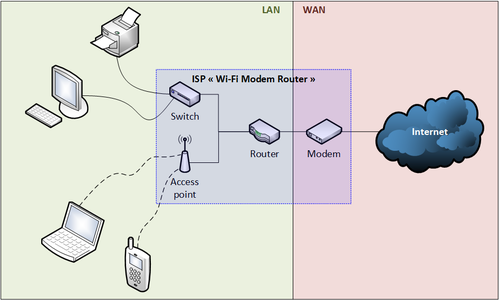

Special note about ISP modems/routers.
Often we say that, for a simple home network, we have a router from ISP. This is not true because the "router" is actually composed of :
- Modem : To connect to the outside world
- Router : To bridge external (WAN) and internal (LAN) networks
- Switch : To propose multiple ports to the user (usually 4)
- Wireless Access point : To provide wireless access straight from the modem
Some equipment now comes with USB ports (printer, hard disk...) or telephone ports (Phone/Voice Over IP, VOIP).

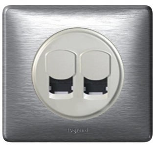

- For neat installation, consider placing female wall plates
