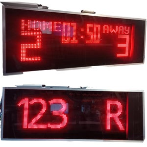

This tutorial shows how to build a large size 960mmx320mm scoreboard. This is just one example, there are more than 30 possibilities. Depending on the size, you can purchase the display modules and accessories to build other types of scoreboards as well.
This tutorial is for single color 6 displays scoreboard. There are more than 30 possibilities, this is just one of them.

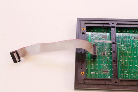

You will see arrows at the back of the display: 1 or 2 pointing upward and 1 or 2 pointing to your right. Place the display on your table exactly as shown in the image.
- Connect the 16-pin IDC cable to the LEFT IDC socket.

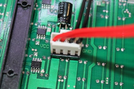

- Connect the power cable to the VCC and GND terminals on the display board. The RED wire goes to the VCC pin, and the BLACK wire goes to the GND pin.

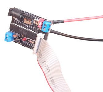

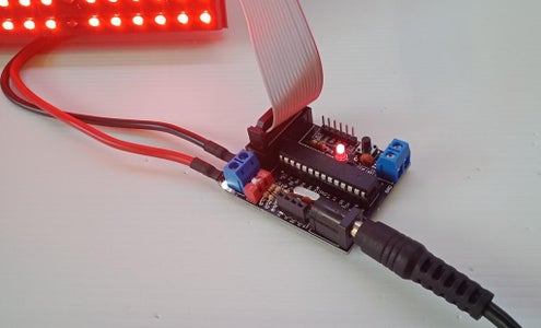

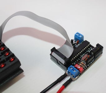

- Use a screwdriver to connect the power cable to the screw terminal of the SCOREDUINO-DMD module.
- Plug the IDC cable into the IDC socket on the SCOREDUINO-DMD board.

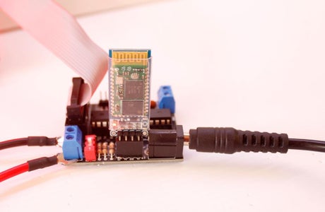

- Attach the HC-06 Bluetooth module to the SCOREDUINO-DMD board.

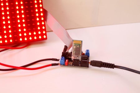

Step 3: Power Up the Scoreboard Display and Scoreduino-DMD Using 5V-6A Power Adapter
After the IDC cable and power cable are connected to the scoreboard, you can power up the SCOREDUINO-DMD module. You will see the output that you have selected while ordering the module.
