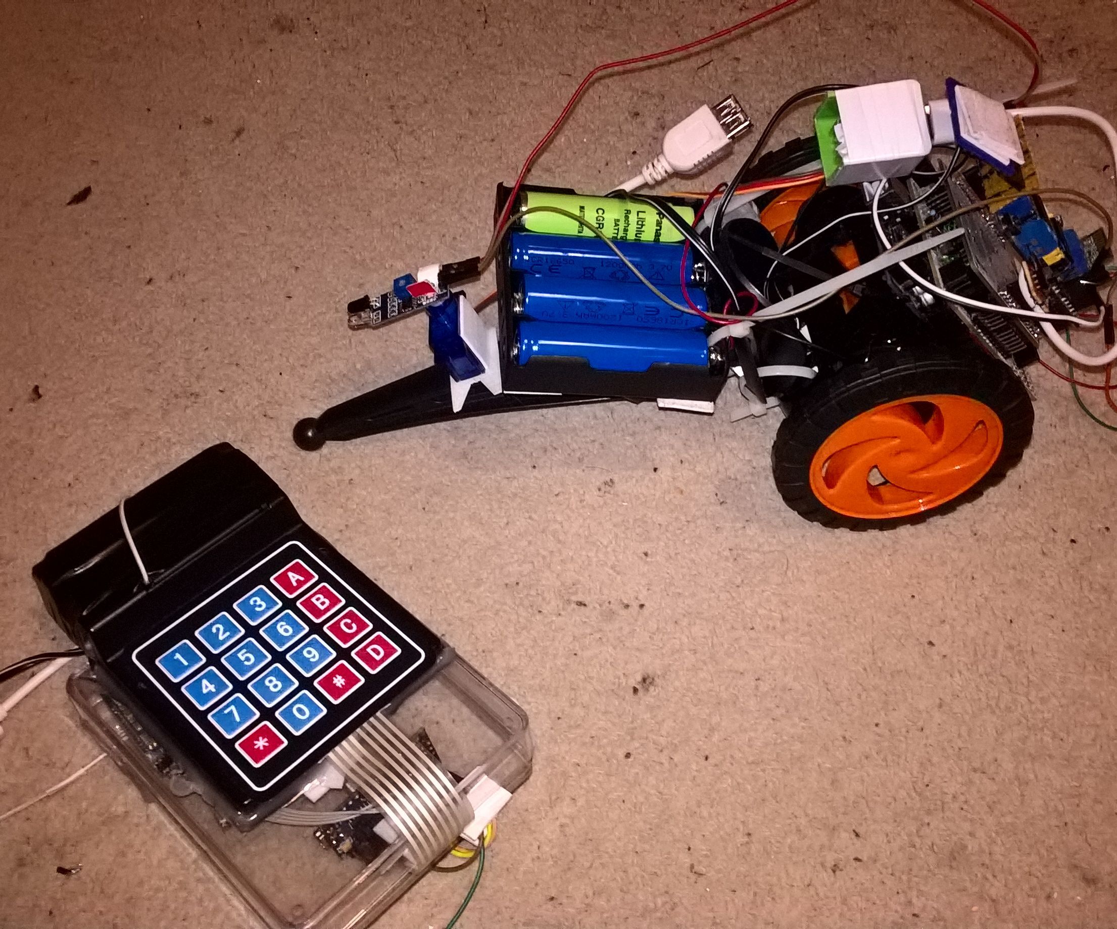

Hi, first off the ultra sound modules are the SR04 type(4 pins), I
tested one through a sketch from the examples and thought wouldn't it be great if I could get more than one working. Well this is the project, still in progress, as most projects are, that accomplishes exactly that. All the sensors were tested individually, making sure I could make a prototype a bit more permanent.
Step 1: Ultra Sound on Breadboard to Prototype
Here's a couple of drafts showing how I wanted them all hooked up. Again I think it's important to show scrappy stuff, like how it started and how it progressed. Also the first video of getting 3 of them working on the breadboard. You can hear the clicks from the sensor when it pings!!
Step 2: Three Ultrasound PCBs
Ok so I made the pcb's and tested with the Arduino Nano, it works really well, much to my surprise. The code is as usual a little raw but I hope it gives you a sense that trial and error is the key thing here, oh and a shed load of patience.
I more or less stumbled upon an idea to use calling methods and functions with several parameters being passed. I had used it passing single values, but never more than 1, it might not be efficient programming however.
