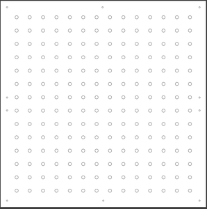

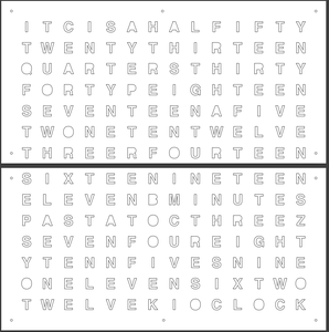

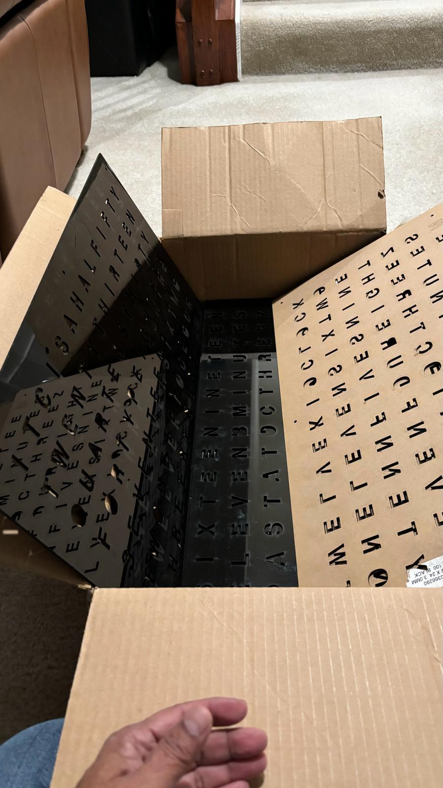

Step 2: CNC Acrylic and Wooden Sheet
CNC frame and files are provided, simply use any online CNC source, I use Oshcut for many of these services. Please also visit your local hackerspace for any opportunities to CNC locally.

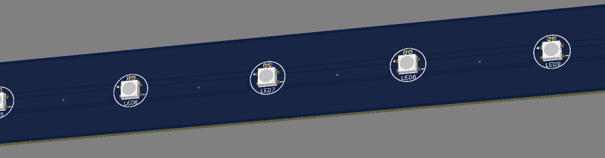

The first method uses available LED breakout boards, available on Amazon and many other locations. The wooden board has precut 10mm holes making it very simply for these individual boards to snap into place. Should you choose this route, I must warn you - there will be many, many soldering connections. For each LED breakout board, you'll need to solder (6) connections and multiply that across (196) LEDs. It is doable but you must have some patience. I'd also strongly advise you should consider stranded wire to prevent solder breakage.
Alternatively, I've created custom PCBs, available on EasyEDA (Project File Link here) to produce and get fabricated from JLCPCB. I recommend this approach given the amount of time and headache you'd avoid.
Once wired up, feel free to test each LED by connecting the LEDs into an Arduino and run a neopixel led test (link here).
