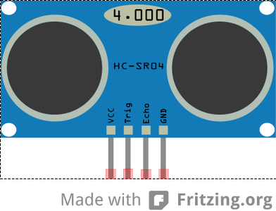

Ultrasonic Sensor (HC_sr04) to Arduino
  • Vcc to 5v
  • Gnd to Gnd
  • Trig to Pin 2 (of Arduino) (for my Gizduino I connected it to pin 12)
  • Echo to Pin 1 (for my Gizduino I connected it to pin 11)

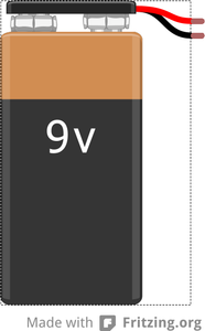

  1. Soldering Battery Cap wires to Switch (power to power- the on switch) and GND to GND pin of Voltage Regulator
  2. Soldering Switch (middle pin of Switch) to Input pin of Voltage Regulator

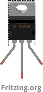

  3. Soldering Voltage regulator to wires of Female USB (output pin of voltage regulator to power wire of female USB)
  4. Soldering Voltage Regulator"s GND pin to GND wire of female USB
