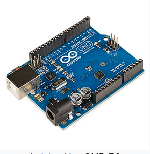

1.Arduino Uno

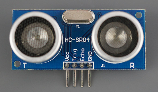

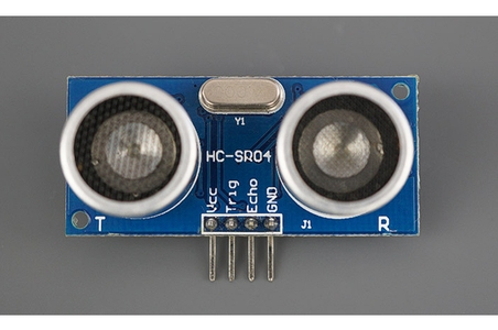

Step 1: UltraSonic Sensor
The Ultrasonic Sensor SR-04 is a widely used distance measuring device that leverages the principles of sound wave reflection. This sensor consists of two main components: a transmitter that emits ultrasonic sound waves and a receiver that detects the waves after they bounce off a nearby object. When the transmitter sends out a sound pulse, it travels through the air until it hits an object and reflects back to the receiver. The time taken for this round trip is then used to calculate the distance to the object, using the speed of sound in air.
The SR-04 sensor is highly valued for its impressive range, capable of measuring distances from as close as 2 cm up to 400 cm, with an accuracy margin of about 3 mm. Its operational voltage of 5V makes it compatible with various microcontrollers, such as Arduino, allowing for straightforward integration and use in projects. Typical applications of the SR-04 include robotic navigation, where it helps in detecting obstacles, monitoring fluid levels, and even in automated parking systems for cars. The combination of affordability, ease of use, and dependable performance makes the Ultrasonic Sensor SR-04 a staple device for electronics projects.
https://cdn.sparkfun.com/datasheets/Sensors/Proximity/HCSR04.pdf

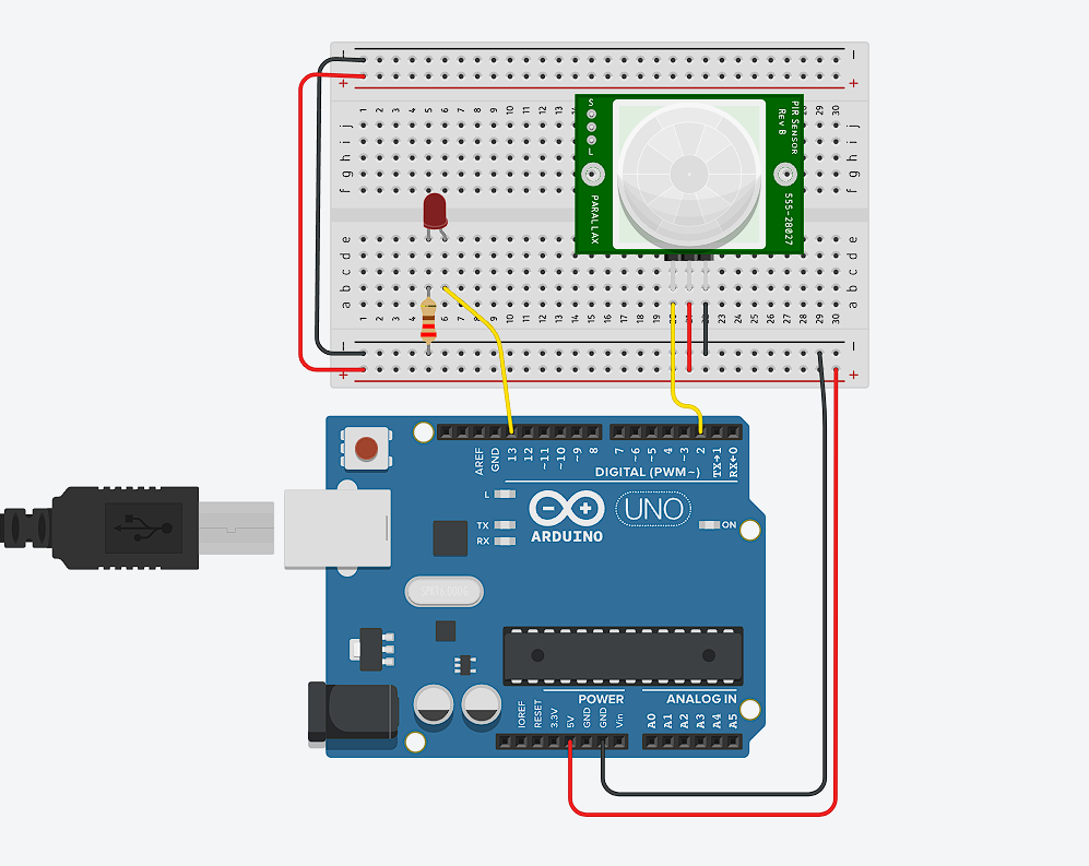

Step 3: Hardware Connection
All the Connections has done as mentioned in the above programme.
