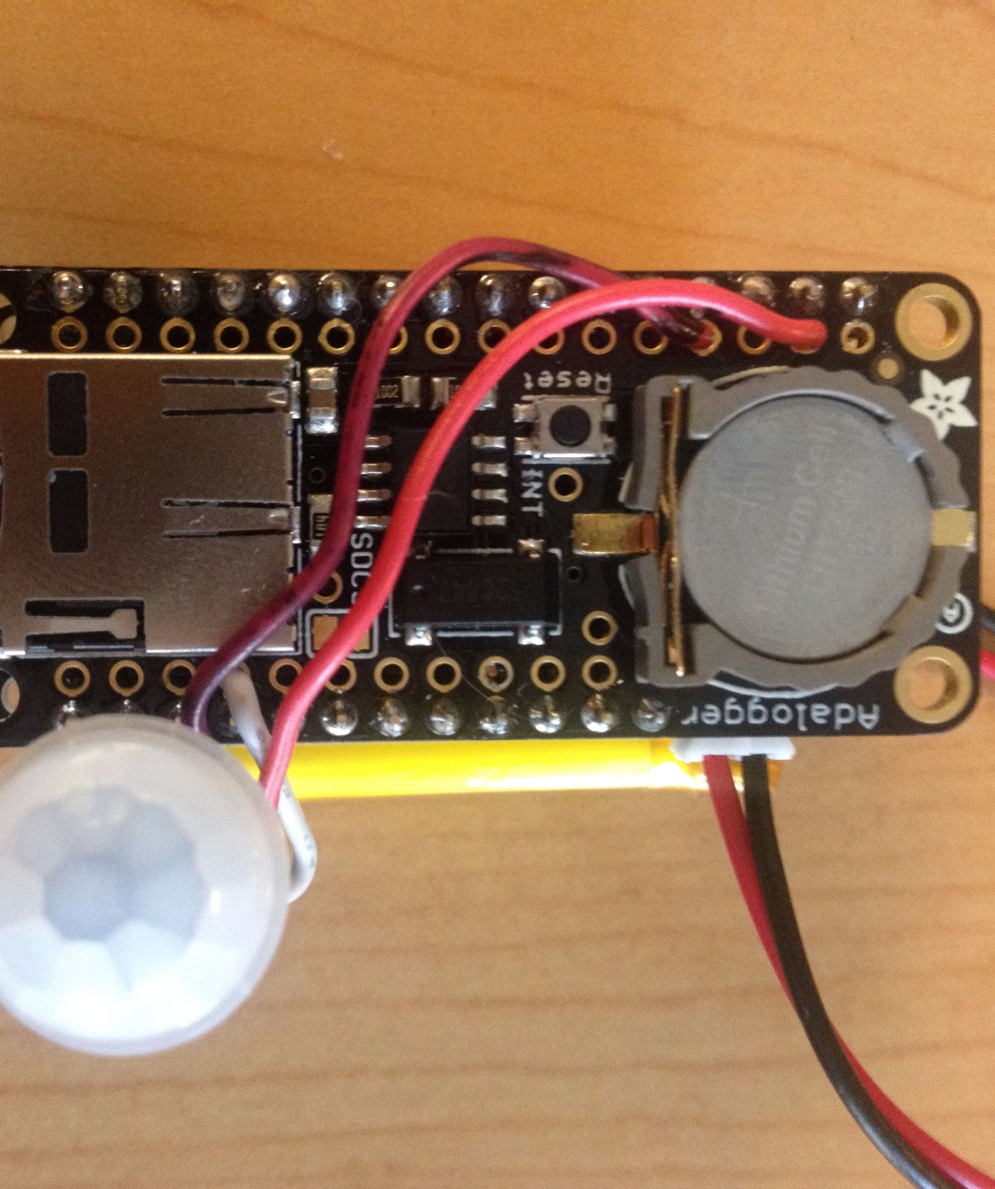

Step 5: Build the Circuit (sensor and Shield)
Gently remove the shield from Arduino. Slot the four HC-SR04 ultrasonic sensor pins through four pads at the front edge of the prototyping area in the shield. Solder jumper wires to the HC-SR04 pins to pads on the shield:
Solder shield 5V pad to HC-SR04 VCC pin
Solder shield GND pad to HC-SR04 GND pin
Solder shield pad 7 to HC-SR04 TRIG pin
Solder shield pad 8 to HC-SR04 ECHO pin
Note: there are no traces between pads in the prototyping area so you need to solder the jumper wires directly to the HC-SR04 pins. Be careful not to accidentally forge a connection between two HC-SR04 pins while soldering. This can cause the sensor to not work properly or, worse, cause irreparable damage to the board, shield and sensor. You should use a solder sucker to remove solder that connects pins by mistake.
