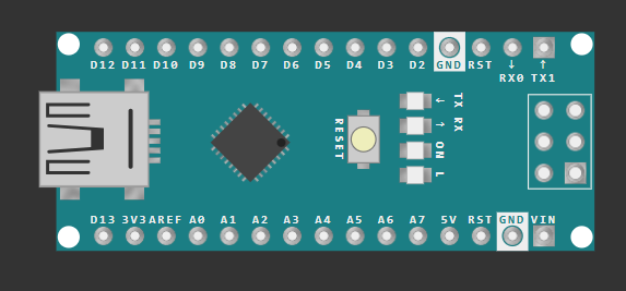

  1. Arduino Nano (you can use any Arduino board)

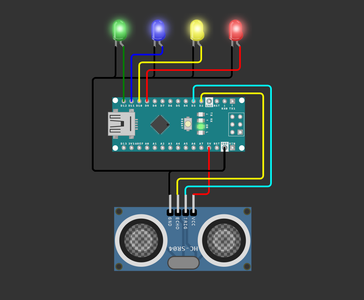

Step 1: Connecting LEDs With Arduino
For this step, we will need four LEDs: Green, Blue, Yellow, and Red. The short leg is the cathode (negative) and should be connected to GND. The long leg is the anode (positive) and will be connected to the Arduino digital pins.
Connections: Now connect the anodes (long legs) as follows:
  1. Green LED → D12
  2. Blue LED → D11
  3. Yellow LED → D10
  4. Red LED → D9
Step 2: Connecting Sensor With Arduino
Now add the HC-SR04 ultrasonic sensor to the circuit. Rotate it 180 degrees for a better wiring position.
Make the following connections:
  1. Echo → D2
  2. Trig → D3
  3. VCC → 5V
  4. GND → GND
