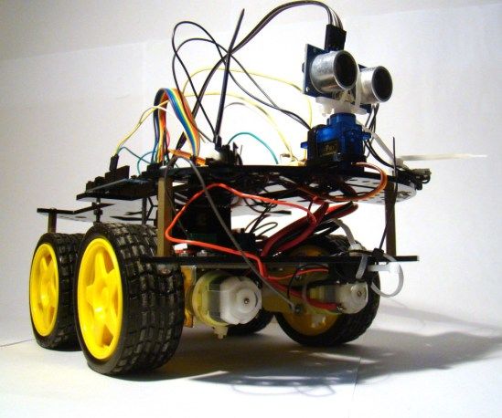

Introduction: Ultrasonic Car + Arduino
Unlike the car that follows the line, that needs a line painted in the ground, this is one completely autonomous, since it can see the distance that things are and deviate from them.
Step 1: Materials
1 x Ultrasonic sensor HC-SR04
1 x Servomotor
3 x Buttons (emergency buttons)
1 x L298N
1 x Chassis
4 x or 2 x Motors (in my case I used 4 that came in the chassis)
1 x Arduino (in my case Mega 2560. OBS: in other Arduino versions operation and connections may vary)
Step 2: Electronics
As the Ultrasound has a 15 degree viewing angle, the servomotor is used to expand this field. Emergency sensors, as the name says, are there in case of an emergency, when one of them is activated, the car goes back and then checks to which direction it should go.
The servomotor was connected to pin 8 of the Arduino
Emergency sensors | Arduino
1 = 22
2 = 24
3 = 26
Ultrasonic sensor | Arduino
echo = 13
trig = 12
L298N | Arduino
in1 = 6
in2 = 5
ena = 7
in3 = 4
in4 = 3
enb = 2
