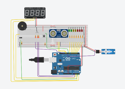

Step 2: How to Build the Circuit
Place the Arduino and breadboard side by side.
Connections
🔹RGB LED (Common anode)
- R → Pin 13 (through 220Ω)
- G → A0
- B → A1
- Anode → 5v
🔹 Ultrasonic Sensor
- Trig → Pin 11
- Echo → Pin 12
- VCC → 5V
- GND → GND
🔹 Button
- One side → Pin 9
- Other side → GND
- Use INPUT_PULLUP or external pull-down resistor
🔹 Slide Switch
- Center pin → A4
- One side → 5V
- Other side → GND
🔹 Buzzer
- Positive → A2
- Negative → GND
🔹 LEDs
- Pins 2–8 each control one LED with 220Ω resistor
- Common GND
🔹 TM1637 4 Digit Display
- CLK → A5
- DIO → A3
- VCC → 5V
- GND → GND
🔹 Servo
- Signal → Pin 10
- VCC → 5V
- GND → GND
Connect the red rail with other side of bread board red rail with wire and connect black rail with the other side of bread board black rail with a black wire.
