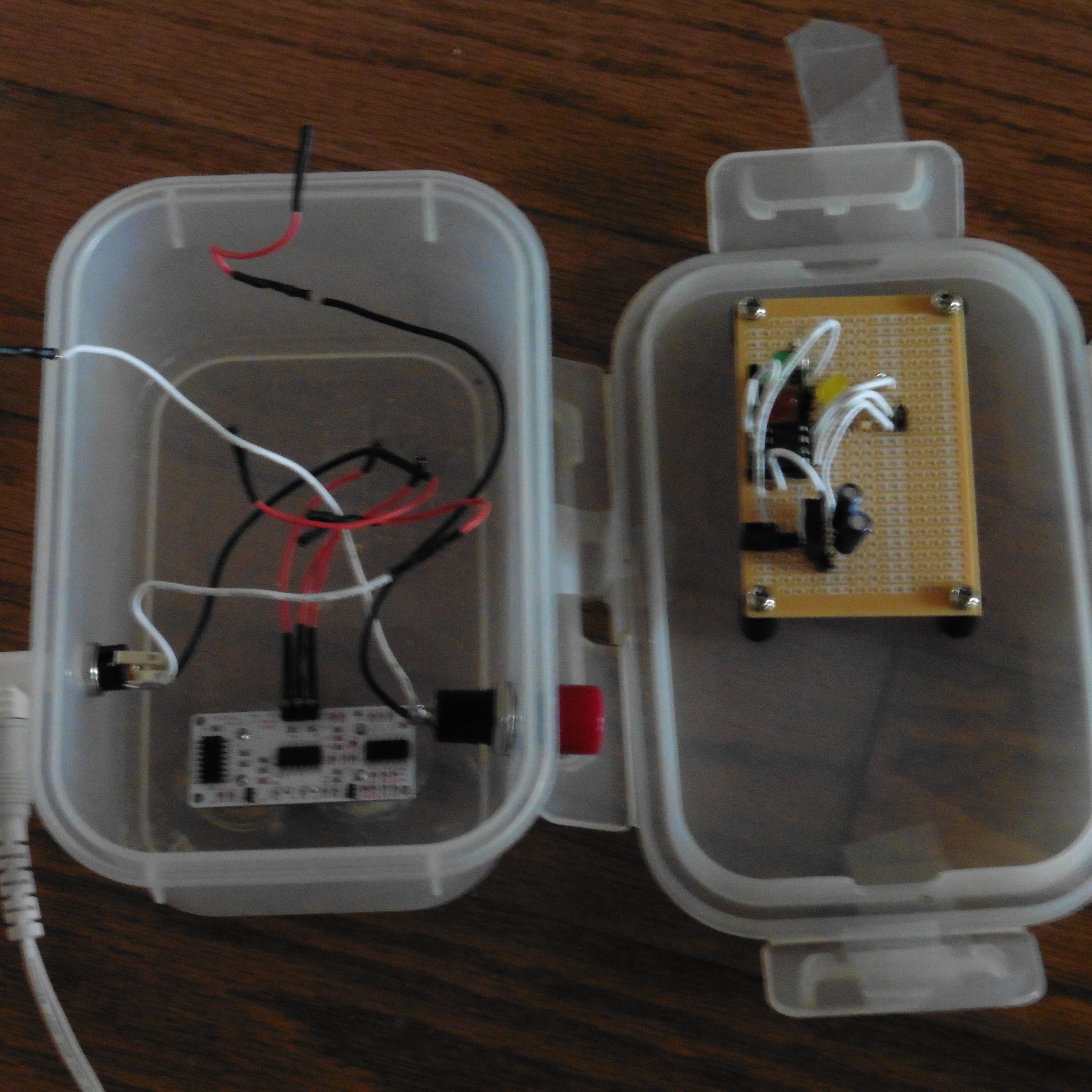

Step 1: Build a Project Box
A great project box for this tupperware. It is particularly good because it is most of the time transparent and even better, it is often frosted. This is all important in spreading the light of the LED to make it as visible as possible. Also, its widely available, cheap and easy to cut. I used the plastic box that came with my Arduino starter kit, which turned out to work quite nicely.
Cut two holes for the ping sensor
This by far the trickiest part. You want try to get them as snug as possible so that you dont have to get out the hot glue gun. The sensors are 16mm wide, so its doubtful that the average person has a drill bit of that nature lying around. This may not be the most orthodox method of cutting holes but with the soft plastic, it worked for me.
First, I drilled a pilot hole in the exact center of where each whole needed to be.
Using some sharp scissors, I pushed it through the hole and twisted* allowing the wedge shape of the scissor blade to widen the hole as I twisted until it was wide enough for the sensor to fit through.
Repeat for the other sensor hole.
Cut a hole for the button
Placing the button on the exterior of the box is crucial for easy access to setting your desired distance. A button with threads and a nut are perfect for this.
Cut a hole for the power plug
Depending on how you plan to power the device will affect what kind of hole you make, I used a 5.5x2.1mm DC power jack to connect it to a 9V power adapter.

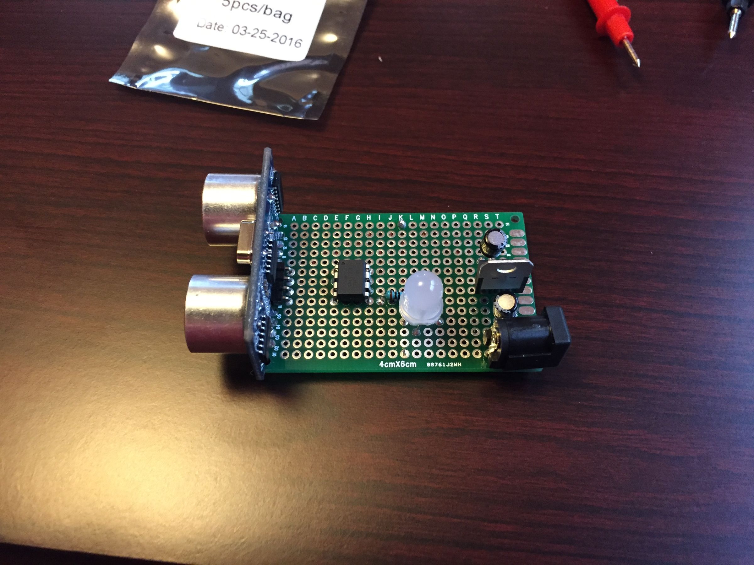

Step 2: Wiring the Circuit
To make this easier to understand lets break the circuit into 3 parts. The LED, the Button and the Ping sensor.
Note, in the photos, I have wired my rails backwards. This is to accomodate the 5V regulator(optional). I realize now that I could have turned it around, used the other rails to not have it backwards but owell.
UPDATE: Adjustment have been made to the circuit diagram. (not reflected in photos) The LED has been routed to pins 0 & 1 in order to use PWM for brightness control. This is important in getting a nice yellow color.
The LED
Connect the common cathode (longest pin) of the LED to a 5V rail on your breadboard. The other 3 pins, require a resistor between them and the connection to the arduino I/O pin. Here is a helpful website to find the kind of resistor you will need http://led.linear1.org/1led.wiz. This is a pull up style circuit so the code will be inverted, high will be off and low will be on. You may use a resistor on the common cathode to not have this situation. I did this because I did not realize the ATtiny85 had pwm pins and I wanted to dim the green LED some by adding 2 resistors. When using red and green to make yellow, green was just too dominant over red an it looked yellow-green. A future fix is to move the green connection to a pwm pin and dim the green via pwm. Here's a link to a more complete tutorial on LED circuits http://www.ladyada.net/learn/arduino/lesson3.html
The Button
Connect 5V to a lead of the button. Connect a 10k ohm resistor between ground and the other lead on the button. Connect a jumper from the arduino to the ground lead of the button. While a common breadboard button will work okay, but if you plan to move it into a project box, it may be a hassle to reach the button. We want to have easy access to the button so that you won't have to move the sensor to press the button, that would make setting your distance quite difficult. I used a threaded momentary button from radio shack. Im not sure if it needs the resistor like the smaller breadboard button but I left it in and it works fine. Here's a link to a more complete tutorial on buttons http://arduino.cc/en/tutorial/button.
The Ping Sensor
Simply connect 5V and GND to your corresponding rails and the echo and trigger pins to the arduino.
Here is a link to the NewPing library which describes all the functions of sensor. http://playground.arduino.cc/Code/NewPing.
Congratulations, your circuit is finished!

Step 3: Upload the Code to the Arduino
First off, dowload and install the latest Arduino IDE (1.0.5) here's a link to the download page http://arduino.cc/en/Main/Software.
We now what to install the NewPing library, Here is a link on instructions to download and install the NewPing library http://playground.arduino.cc/Code/NewPing.
If you plan on using the ATtiny then part of the file NewPing.cpp must be edited. There are two big section of the code devoted to timers, comment all of this out. NewPing.h can be left alone.
It is important to use this library and NOT to perform the distance measurement manually. The reason is because when the ping sensor cannot return a distance, it will delay for a full second instead of multiple times per second like it should. This is a problem when pulling the car in and there is no response from the unit for a brief period. In that time a car can move several feet and make the device useless. This library fixes that issue thus maintaing responsiveness.
The pin arrangement will be however you chose to connect up your arduino board, so be sure to adjust this code to work with your circuit. Remember, if you want to use pwm to get your color brightness just right be sure to use pins with a ~ symbol for your LED or refer to the ATtiny85 pinout diagram for pwm pins. I did not include any use of the blue pin, simply because the ATtiny85 does not have enough pins without reprograming the reset pin to be I/O. I didn't bother to do so.
You may want to add some new colors or change it up to suit your mood. If you need a more precise indication, you may want to lower the range value to 1 or 2 (keep in mind that its +/-, so a 2 for the range variable will give a 4 inch range) or bring it up higher if you have room to spare. You may also want to edit the distances at which each color of LED will change. I found 120 and 50 inches to be just right.
UPDATE: LED has been moved to pins 0 & 1. The yellow() method has been updated to include PWM. You may have to find which values work best with your LED.

Step 4: Uploading the Software to an ATtiny85
In order to make this project more permanent, cheaper, smaller and all around more legit. I will show you the steps required to shrink all of this down to a chip the size of your thumbnail.
First we need to install ATtiny support to Arduino IDE.
Locate your Arduino sketchbook folder (you can find its location in the preferences dialog in the Arduino software)
Create a new sub-folder called “hardware” in the sketchbook folder, if it doesn’t exist already.
Download attiny-master.zip folder from below and copy the “attiny” folder (not the attiny-master folder) from the unzipped ATtiny master.zip to the “hardware” folder. You should end up with folder structure like Documents > Arduino > hardware > attiny
Restart the Arduino development environment.
You should see ATtiny entries in the Tools > Board menu.
A great tutorial to this can be found here http://hlt.media.mit.edu/?p=1695
Uploading software to ATtiny85
The Arduino board can be used as a programmer for the ATtiny chips. To do so plug the ATtiny chip into a breadboard and wire a breadboard in the following way.
1. With jumpers, connect VCC to 5V and GND to GND. Connect pin 10 to Reset, 11 to pin 0, 12 to pin 1, 13 to pin 2.
2. Open the program ArduinoISP from File -> Examples -> ArduinoISP. Upload it to the board.
3. Connect a 10uf capacitor between Reset and GND of the Arduino board.
4. Now open a blank program, only void() and setup() methods are present and are blank. (Im not sure about this step but I tried doing it with code in it and it broke the ATtiny)
5. Select from Tools -> Board -> ATtiny85 (internal 8MHz clock) and select from Tools -> Programmer -> Arduino as ISP. Upload the blank program. (you should see 2 avrdude errors. Not to worry, this is normal)
6. Select from Tools -> burn bootloader. This changes clock speed from its default 1MHz to 8MHz.
7. Now go back to the parking sensor code and upload it. Be sure to have the correct board and programmer selected. (you should see the same two avrdude errors)
If everything went smoothly, carefully pull the ATtiny out and transplant it back into your breadboard circuit.
Next, we need to modify the circuit. Because we are removing the Arduino board from the equation, we are also losing its regulated power supply, so we need to make our own. This will require 2x 10uf electrolytic capacitor and a 5V regulator.
The Regulator
Connect the incoming positive voltage to the input lead and the negative to negative lead of 10 uf capacitor, connect these two leads to their respective input and negative pin on the regulator. Arrange this on the bread board so that a the negative and output pins are plugged into a vertical rail. Add another 10 uf capacitor after the 5V regulator on the vertical rails, to their respective lead, of course. The capacitors smooth out the voltage. I am using a 9V DC power adapter, this is low enough to not require a heat-sink on the regulator but if you go higher, then you might need to add one. Now that the circuit is modified, let's get it on* the ATtiny85. Here is a helpful instructable that I used myself https://www.instructables.com/id/How-to-make-your-own-Arduino-board/step3/Adding-the-5v-regulator/.
All that's left is to connect up a power source!
