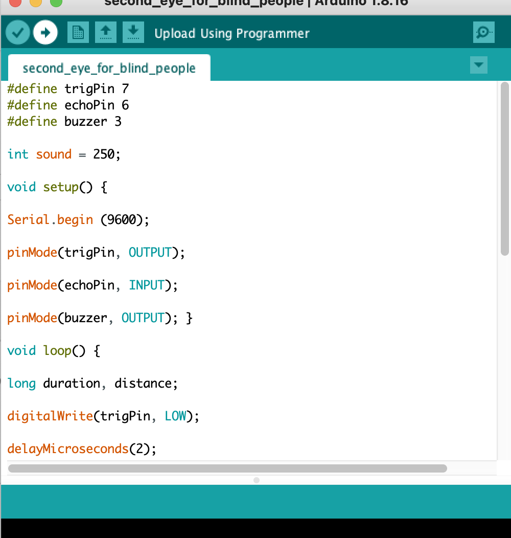

Step 2: Coding in Arduino IDE
#define trigPin 7
#define echoPin 6
#define buzzer 3
int sound = 250;
void setup() {
Serial.begin (9600);
pinMode(trigPin, OUTPUT);
pinMode(echoPin, INPUT);
pinMode(buzzer, OUTPUT); }
void loop() {
long duration, distance;
digitalWrite(trigPin, LOW);
delayMicroseconds(2);
digitalWrite(trigPin, HIGH);
delayMicroseconds(10);
duration = pulseIn(echoPin, HIGH);
distance = (duration/2) / 29.1;
if (distance < 30) {sound = 50;}
 if (distance < 25) {sound = 100;}
 if (distance < 20) { sound = 150;}
if (distance < 15) { sound = 200;}
 if (distance < 10) { sound = 250;}
 if (distance < 5) { sound = 300;}
 if (distance > 35 || distance <= 0)
{ Serial.println("Out of range");
noTone(buzzer); }
else { Serial.print(distance); Serial.println(" cm"); tone(buzzer, sound); }
delay(200);}
