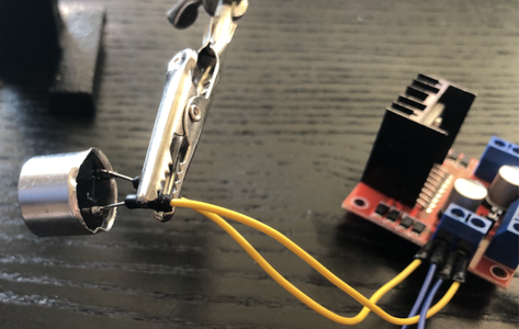

Step 3: Assemble and Test Circuit
To make the circuit, follow the schematic provided.
Once everything is set up, solder wires from the to the transmitters from Step 1. Make sure to pay attention to the wire connections from the transmitters to the LN chip, this is an easy thing to overlook.
To test, connect the battery using jumper wires to the breadboard and the LN chip and Arduino will both light up as an indication of a complete circuit. A faint buzzing noise will also occur within the sensors, another indicator that the circuit is working.
This is where the netting from Step 1 comes in handy. Using hot glue, glue the netting to a toothpick and this will be your device to insert the styrofoam between the sound waves. This is much easier than using your hands or tweezers.
It will take some adjusting with the toothpick and the distance between the sensors. For this step, use a clamp or helping hands to hold the sensors in place. The distance that I kept for the sensors was always around 0.4-0.6 inches.
