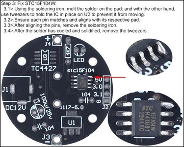

Step 1: Install 1 SMD Component (SOP-8 STC15F104W) on U2
There is a white seam on the PCB silkscreen at the U2 location, and there is a dot on the IC. These two points correspond to each other and indicate the installation orientation.
Step 2: Randomly Select a Solder Pad on the PCB and Melt the Solder on the Pad
Note: Observe the picture carefully before soldering.
Step 3: Fix STC15F104W
- Using the soldering iron, melt the solder on the pad, and with the other hand, use tweezers to hold the IC in place on U2 to prevent it from moving.
- Ensure each pin matches and aligns with its respective pad.
- After aligning the pins, remove the soldering iron.
- After the solder has cooled and solidified, remove the tweezers.

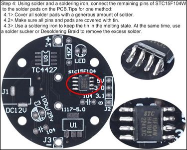

Step 4: Using Solder and a Soldering Iron, Connect the Remaining Pins of STC15F104W to the Solder Pads on the PCB
Tips for one method:
- Cover all solder pads with a generous amount of solder.
- Make sure all pins and pads are covered with tin.
- Use a soldering iron to keep the tin in the melting state. At the same time, use a solder sucker or Desoldering Braid to remove the excess solder.

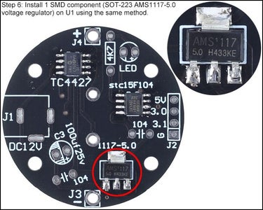

Step 6: Install 1 SMD Component (SOT-223 AMS1117-5.0 Voltage Regulator) on U1 Using the Same Method

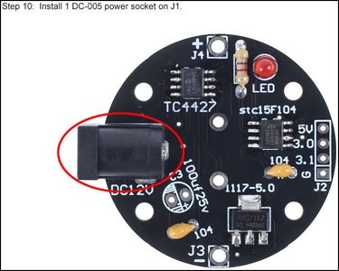

Step 10: Install 1 DC-005 Power Socket on J1

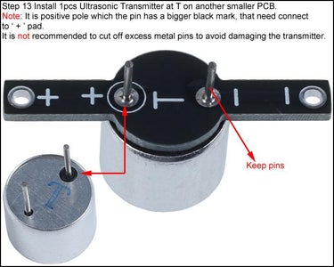

Step 12: Install 1pcs Ultrasonic Transmitter at T on PCB Another Side.
Note: It is positive pole which the pin has a bigger black mark, that need connect to ‘ + ’ pad. It is not recommended to cut off excess metal pins to avoid damaging the transmitter.
Step 13: Install 1pcs Ultrasonic Transmitter at T on Another Smaller PCB.

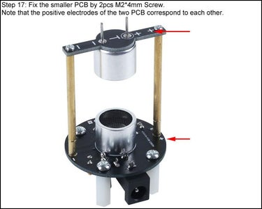

Step 16: Fix 2pcs Spliced 46mm Copper Pillar on the Bigger PCB
Step 17: Fix the Smaller PCB by 2pcs M2*4mm Screw
Note that the positive electrodes of the two PCB correspond to each other.
