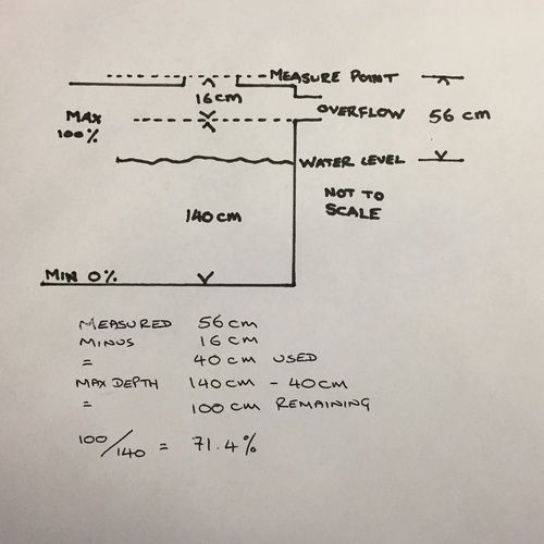

Step 1: The Maths...
After toying with several ideas on how to determine the water level - I decided on an ultrasonic transmitter/receiver as the basis for my widget, and using an Arduino to take the readings and do all the maths. The readings returned from the sensor are (indirectly) in the form of a distance - from the ultrasonic sensor to the surface it has bounced off (the water surface - or bottom of the tank, if empty), and back again, so we need to do a few things with this, in order to get to a percentage remaining in the tank.
NB - in actual fact, the value returned from the sensor is really just the time taken for the signal to leave the emitter side and return to the receiver. This is in microseconds - but knowing the speed of sound is 29 microseconds per cm (What? You didn't know that? Pfft...) makes an easy conversion from a time period to a distance measurement.
First - of course, we need to divide the distance by 2 to get the sensor to surface distance. Then, subtract the constant distance from the sensor to the 'max' water depth. The remaining value is the depth of water that has been used. Next, subtract that value from the max water depth, to find the depth of water left in the tank.
This value then, is the basis for any other calculations, such as working out this depth of water as a percentage of the maximum depth, or multplying the depth by the constant 'surface area', to get a volume of water which can be displayed in litres (or gallons, or any other unit - as long as you know the maths to do it - I'm sticking to a percentage for simplicity).

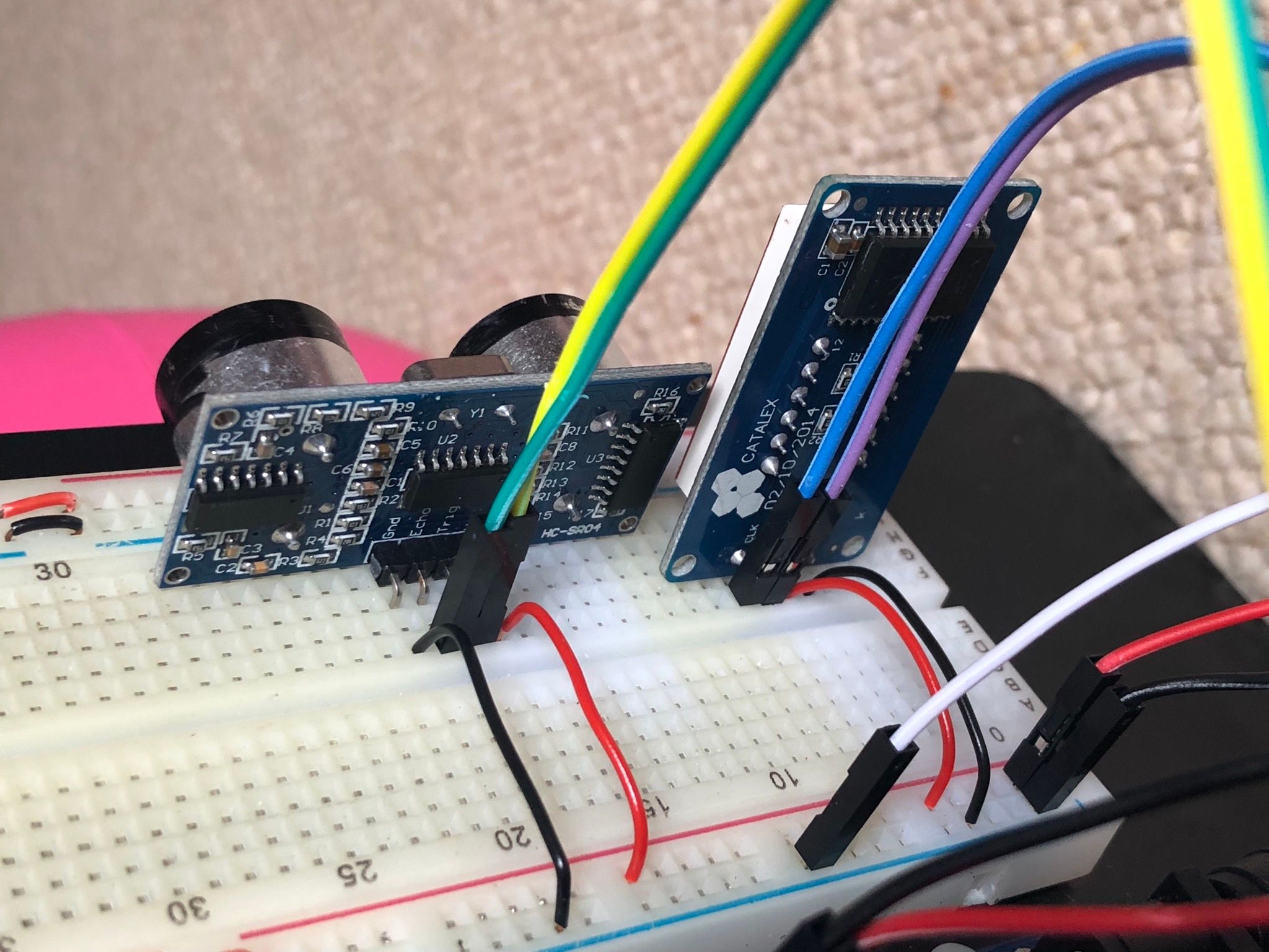

Step 4: Testing the Prototype (and Code)
Having purchased the HC-SR04 from a cheap Chinese source on ebay, I wasn't really expecting to receive a hugely accurate unit, so I wanted to test it out on the breadboard first, in case I needed to add some distance correction code into my sketch.
At this point, I was casting around for basic info on how to connect up and use the HC-SR04, and must acknowledge jsvester's instructable "Simple Arduino and HC-SR04 example". His example and experience was a great starting point for me to start coding from.
I found the NewPing library of functions for the HC-SR04, which includes built-in functionality to take the average of multiple readings, thereby making my code a lot simpler.
I found a library for the TM1637 clock display module as well, which made displaying numbers a lot simpler. In my original code (for the 4-digit 7 segment display), I was having to split the number into individual digits, then build each individual digit on the display by knowing which segments to illuminate, and then cycling through each digit in the number, and building that number on the appropriate display digit. This method is called multiplexing, and effectively displays just a single digit at a time, but cycles through them from one digit to the next so quickly, that the human eye doesn't notice, and fools you into believing that all the digits are on at the same time. As with the HC-SR04 library making the measuring operations easier, this display library takes care of all the multiplexing, and digit handling. The Arduino Reference pages linked to above, give some examples, and of course, each library comes with sample code that can be a great help.

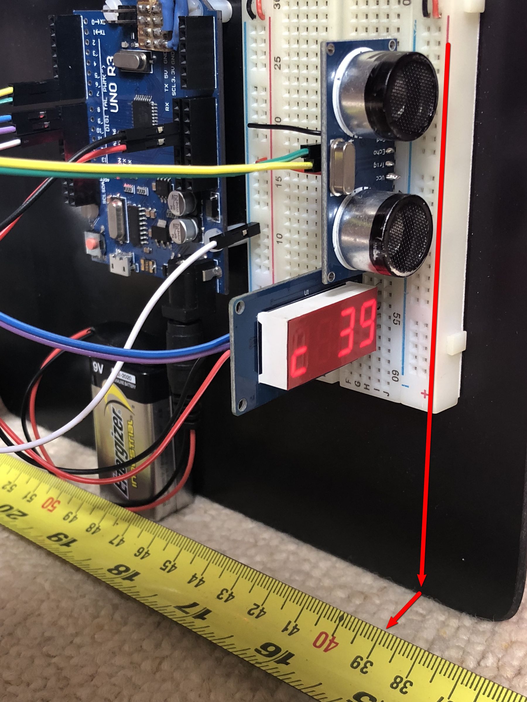

So, the pictures above show my test rig - I am testing it on my Arduino Uno for simplicity, as that is already setup for temporary re-usable connections for prototyping. The unit is operating in 'Calibration' mode here (notice that digital pin 10 - the white wire - is connected to ground) and accurately reading 39cm to the box I had randomly placed in front of it, as shown by the tape measure. In this mode, I display the small 'c' ahead of the measurement, just to indicate it is not the normal measurement.
As well as Vcc (5v) and Ground, the HC-SR04 needs 2 other connections - the trigger (yellow to pin 6) and echo (green to pin 7). The display also needs Vcc (5v) and Ground, and 2 more connections - clock (blue to pin 8) and DIO (purple to pin 9). As already mentioned, the operating mode is controlled by a high or low on pin 10 (white). The connections will use the same pins on the Arduino Pro Mini, but will be permanently soldered. The operating mode will be selectable using a jumper across two out of three header pins, connected to Vcc, pin 10, and ground respectively.
The official specs for the HC-SR04 claim something like a maximum error of just 3 millimeters up to the maximum designed operating distance of 4 metres, so imagine my surprise to find that my unit certainly was accurate to that degree up to 2 metres - which is well in excess of what I need. Due to limited space for a quick and dirty test setup, my test results beyond that distance were being corrupted by reflections from surfaces other than my test target, as the beam from the transmitter spread out and took in a wider area. But as long as it is good to 1.5 metres - that'll do me nicely, thank you very much :-)

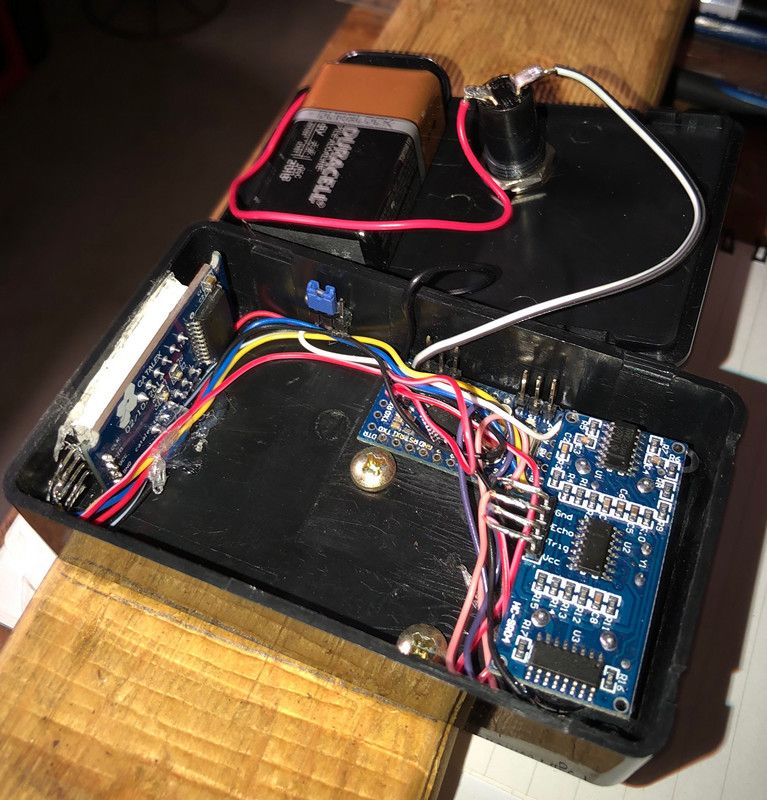

Step 7: Assembly

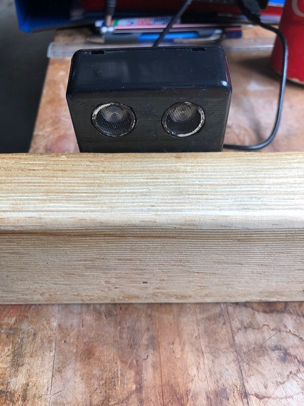

As I mentioned, I took a punt on the case, and regretted it. To fit all the components in was a real squeeze. In fact I had to bend the push button contacts out sideways, and put some packing on the outside to lift it a bit further so that it would fit in the depth of the box, and I had to grind 2-3mm off each side of the display module board for it to fit too.
I drilled 2 holes in the case for the ultrasonic sensors to poke through. I drilled the holes a little too small and then gradually increased them using a small rotary grinder, so I could get them to be a nice 'push fit'. Unfortunately, they were too close to the sides to be able to use the grinder from inside the box, and this had to be done from outside, resulting in many scratches and skate marks where the grinder slipped - oh well, that's all on the bottom anyway - who cares..?
I then cut a slot in one end that is the right size for the display to poke through. Again - my guess on the box size bit me on the rear as the slot left me with a very slim piece above the display, which inevitably broke while I was filing it smooth. Oh well - that's what super-glue was invented for...
Finally, with all the components roughly positioned in the box, I measured where to put the hole in the lid, so that the body of the push button would fall into the final available space. JUST!!!

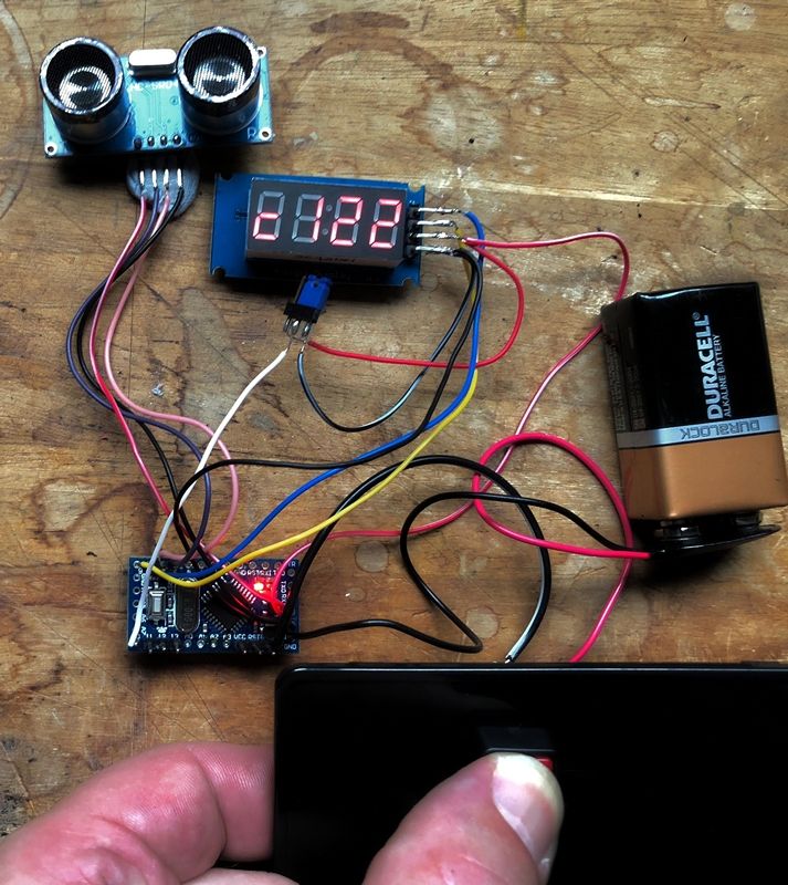

Next, I soldered all the components together to test they all still worked after my bending and grinding and trimming, before assembling them all into the case. You can see the jumper connection just below the display module, with pin 10 on the Arduino (white lead) connected to Gnd, thus putting the unit in calibration mode. The display reads 122cms up from my bench - it must have picked up a signal reflected back from the top of the window frame (its too low to be the ceiling).
Then it was a case of breaking out the hot glue gun, and shoe-horning all the components into place. Having done that, I found that the tiny clearance between the top of the display module and the lid, once the module was glued in place, left a bit of a bulge where the lid won't quite fit as snugly as I'd like. I might try and do something about that one day - or more likely, I won't...
Step 8: The Finished Article

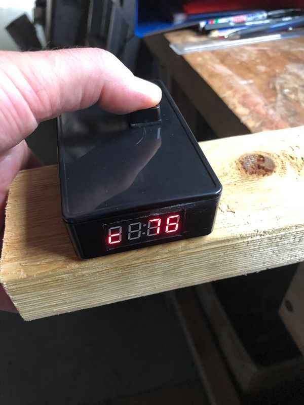

After a few post-assembly tests, and a correction to my code to account for the depth of the chunk of wood I'd screwed the device to (which I completely overlooked in my calculations - d'oh!!), it's all done. Finally!
Assembled testing

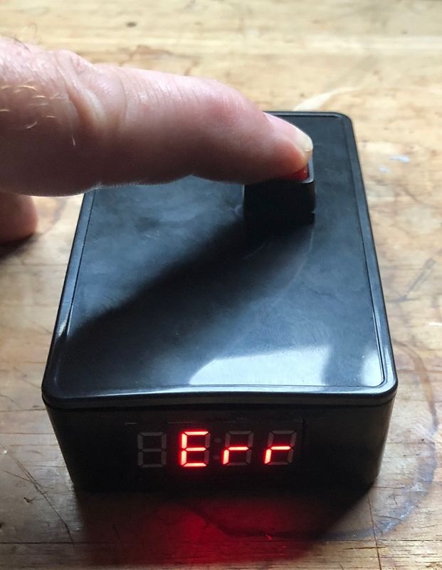

With the unit just sitting face down on my bench, obviously there will be no reflected signal, so the unit correctly shows an error condition. The same would be true if the closest reflecting surface is beyond the unit's range.
Looks like from my bench top to the floor is 76cms (well, 72cms plus the 4cm depth of the chunk of wood).
The underside of the unit, showing the transmitter and receiver overhanging the chunk of wood - I should really stop calling it a chunk of wood - it will henceforth be referred to as the Gauge Stabilisation and Precision Placement Platform! Thankfully, this is probably the last time I'll mention it ;-)
Ooh - you can see all those nasty scratches and skate marks in this one...

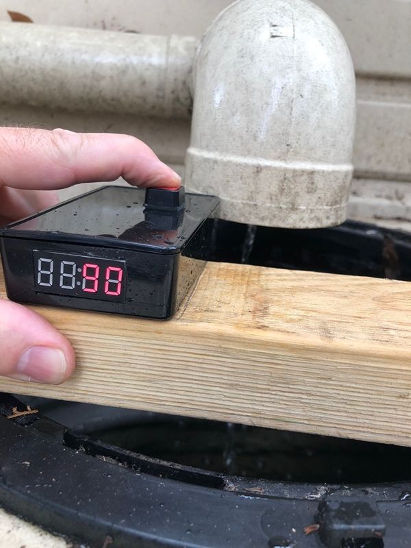

... and here is the finished item, placed in normal operating mode, actually measuring the capacity of my tank to the nearest 5%. It was a (very) rainy Sunday afternoon that saw me finish this project off, hence the raindrops on the unit, and the very pleasing 90% reading.

Step 9: Postscript - One Hundred (and Five) Percent?
So, on the Monday after the rainy Sunday, the tank was absolutely as full as it could possibly be. As it is one of the very few times I have ever seen it completely full, I thought it would be the ideal time to benchmark the gauge, but guess what - it registered as 105%, so there was obviously something wrong.
I got out my dipstick and found that my original assumptions of 140cms as the maximum depth of water, and 16cms of headroom (based on visual guesstimates made from outside the tank), were both a little off the actual measurements. So armed with the real data for my 100% benchmark, I was able to tweak my code and reload the Arduino.
The maximum water depth turns out to be 147cms, with the measuring point sitting at 160cms, giving 13cms of headroom (the sum of the headroom within the tank, the height of the neck of the tank, and the depth of the chunk of... whoa, no, what?! I mean depth of the Gauge Stabilisation and Precision Placement Platform!).
After correcting the maxDepth and headroom variables accordingly, as well as resetting the maximum range of the sonar object to be 160cms, a quick retest showed 100% that dropped to 95% as I lifted the gauge a little (to simulate a small amount of the water having been used).
Job done!
