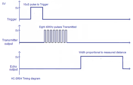

2) Trigger: The trigger signal for starting the transmission is given to this pin. The trigger signal must be a pulse with 10uS high time. When the module receives a valid trigger signal it issues 8 pulses of 40KHz ultrasonic sound from the transmitter. The echo of this sound is picked by the receiver.

From the timing diagram, you can see that the 40KHz pulse train is transmitted just after the 10uS triggering pulse and the echo output is obtained after some more time. The next triggering pulse can be given only after the echo is faded away and this time period is called the cycle period. The cycle period for HC-SR04 must not be below 50mS. According to the datasheet, the distance can be calculated from the echo pulse width using the following equations.
Distance in cm = echo pulse width in uS/58
