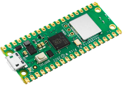

  • Raspberry Pi Pico RP2040

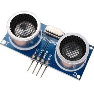

  • HC-SR04 Ultrasonic sensor

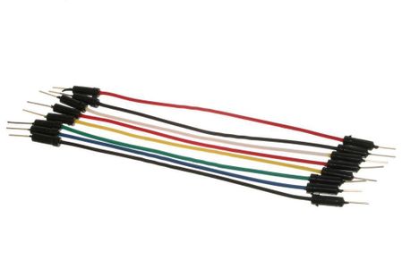

  • Jumper wires

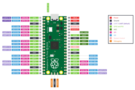

Step 2: The Circuit
  • Connect OLED Display pin [VCC] to Pi Pico RP2040 pin [VBUS]
  • Connect OLED  Display pin [GND] to Pi Pico RP2040 pin [GND]
  • Connect OLED Display pin [SDA] to Pi Pico RP2040 pin [4]
  • Connect OLED Display pin [SCL] to Pi Pico RP2040 pin [5]
  • Connect HC-SR04 pin [VCC] to Pi Pico RP2040 pin [VBUS]
  • Connect HC-SR04 pin [GND] to Pi Pico RP2040 pin [GND]
  • Connect HC-SR04 pin [Trigger] to Pi Pico RP2040 pin [3]
  • Connect HC-SR04 pin [Echo] to Pi Pico RP2040 pin [2]

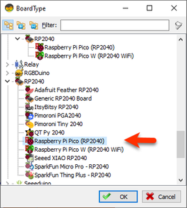

Step 3: Start Visuino, and Select the Raspberry Pi Pico (RP2040) Board Type
Start Visuino as shown in the first picture Click on the "Tools" button on the Arduino component (Picture 1) in Visuino When the dialog appears, select "Raspberry Pi Pico (RP2040)" as shown on Picture 2

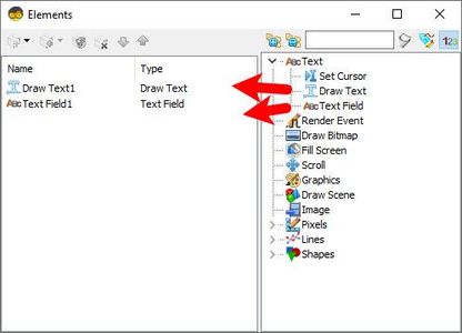

  • Add "OLED I2C" component
  • Double click on the "DisplayOLED1" and in the "Elements" window drag "Draw Text" to the left side and in the Properties window set "Size" to 2 and "Text" to Distance

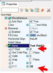

  • Drag "Text Field" to the left side and in the Properties window set "Size" to 2 and "Y" to 30
  • Close the "Elements" window
