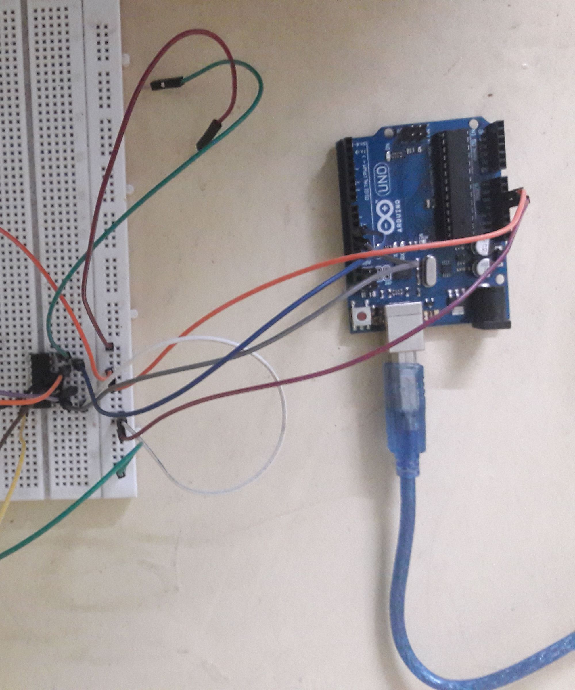

Step 2: Lets Make.
The ultrasonic sensor has 4 pins: Vcc, Trig, echo, GND.
Just like shown in the diagram, 5 volt is applied at the Vcc to power the sensor. Here GND denotes ground. The trigger pin(Trig) is connected to i/o pin numbered 13 and the echo is connected to pin number 12.
The trigger pin produces an ultrasonic sound which may collide with an object and it is reflected. The reflected wave comes to the echo pin and it is analyzed using arduino.
An led is connected to the pin 7. Make sure that you use a resistor while connecting led otherwise there are chances that you will blow up the led.
