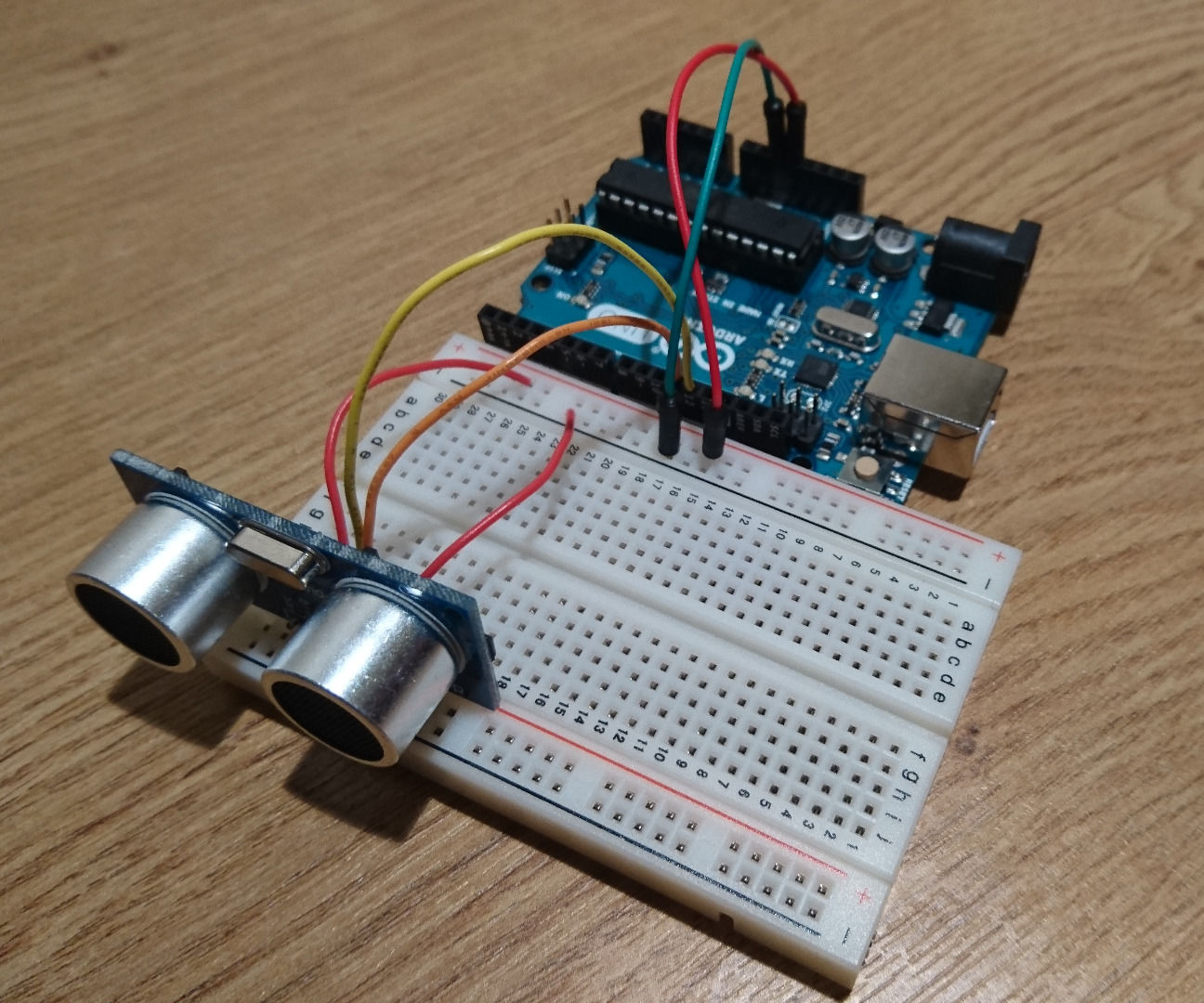

Hardware
- Arduino
- Ultrasonic sensor (I am using an HC-SR04, can use others)
- Breadboard
- Jumper cables
- USB

Step 1: Step 1: Setting Up the Arduino
To set up the Arduino you should look at my first Instructable.
You can find it here:
https://www.instructables.com/id/Ultrasonic-sensor-in-openFrameworks-using-Arduino/
