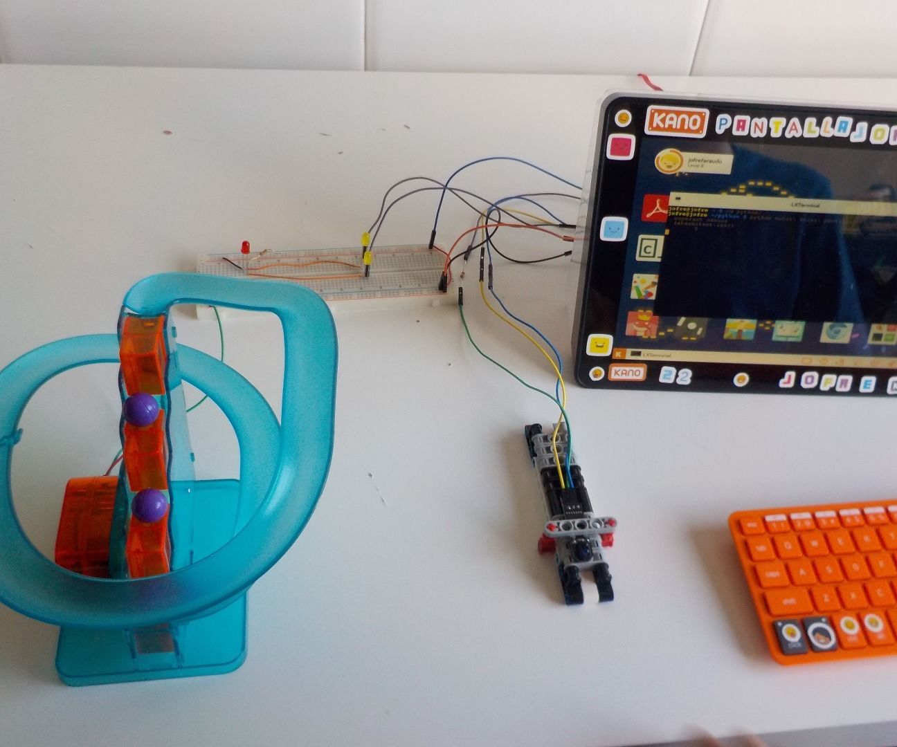

Introduction: Ultrasonic Theremin With Scratch for Raspberry Pi
Control a ultrasonic distance sensor with Scratch for raspberry Pi and use in the ultrasonic theremin project of MagPi magazine (issue 58).
Note:
The project uses a Python program to send the sensor data to the Scratch program.

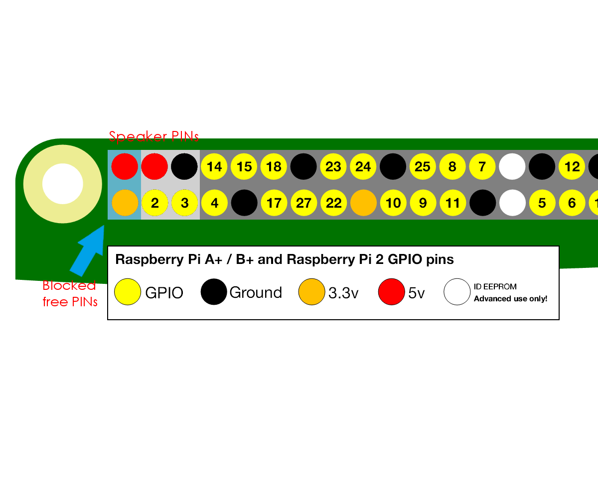

Step 1: Build the Circuit.
Build the circuit following this scheme.

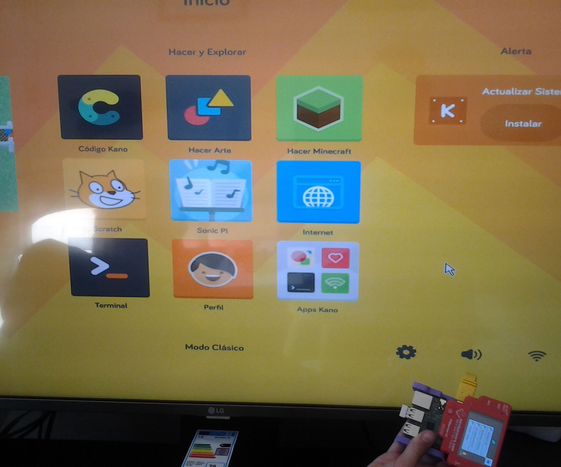

Step 2: Install Python Libraries and Make the Program
To communicate Python wtih Scratch we need Scratchpy library.
Go to the tenrminal and type:
sudo pip install scratchpy
You will need the gpiozero library (preinstalled in raspbian).
Download the Python program here.
